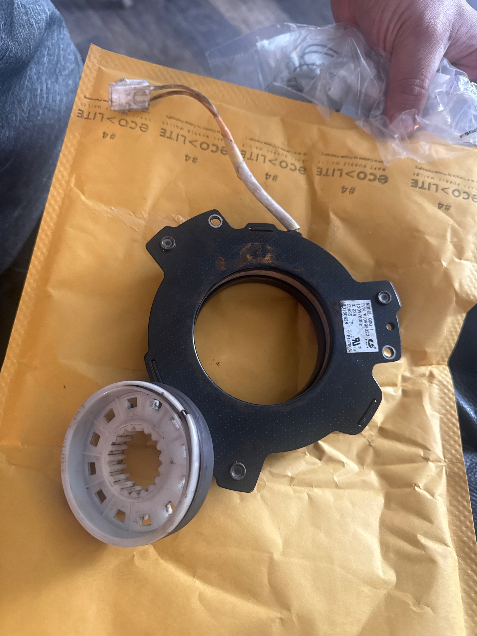

Maytag Washer, Bad Noise with No Agitation
Brand: Maytag
Model Number: MVWB865GW0
Main Symptom: Noise and does not agítate
Washer starts normal filling up with water but does not agítate and stops. It will drain and spin if I put on that option. It makes a noise when it tries to wash and agitate. I’ve changed the transmission, no luck, the clutch and nothing, changed the clutch accessories which was pretty rough and still same issue. I’ve ran out on ideas it may be.
Error Code (if any):N/A
Parts or tests already tried:Transmission, clutch and clutch accessories
It would be recommended to put the unit into service diagnostics mode and see if there are any error codes. Error codes will guide you to what may be causing this issue.
