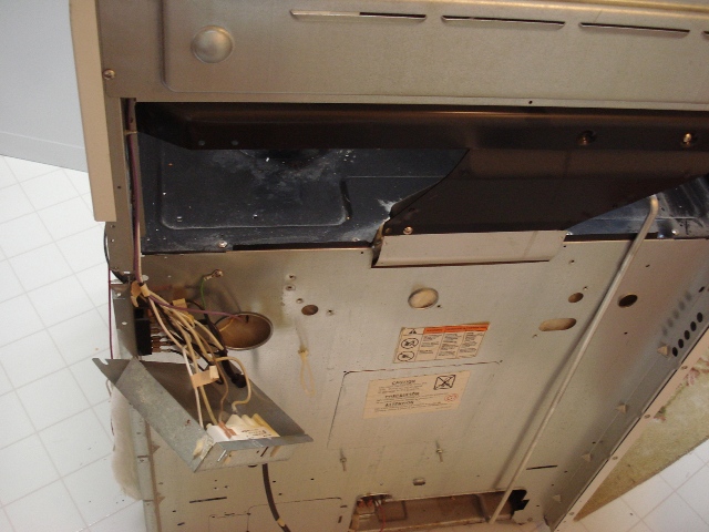

[ATTACH]1851[/ATTACH][ATTACH]1852[/ATTACH][ATTACH]1853[/ATTACH]Gene I ordered the part that was for my model # PGR4310CDW, However the original part and the new part are different sizes and look totally different. any suggestions on how to install the new one?
The new one is bigger and there is no way to mount it in the original position. Also I have no way of knowing where the connections go. I see there are 2 power connections and 2 connections that go to the spark assy. Do you know how I can find out what to do here.

This is what mine looks like. I checked the model # 2x and I did have the correct stove model #, however the part you referred me to and the one that is on the web site does not match.
What do you recommend?

The spark module with the part number AP4094158 comes up as a search result by your model number. All these diagrams came from the manufacturer and I do not know why they used this part. It is possible to install it instead of the original, but it needs some alterations.
The spark module you found looks almost exactly as the original and you definitely can use it. Contact the Appliance Parts Pros customer service and they will exchange the part.
