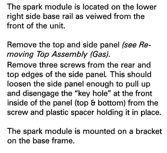

Don’t see spark module. Could you tell me where the spark module is located?
Need a little more help. :face_with_diagonal_mouth:
The spark module is located on the lower right side base rail as viewed from the front of the unit.
