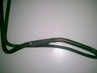

I got the part in yesterday and installed it myself ( with no help from my husband ) :slight_smile: . So far, everything seems to be working. It was the heater that malfuctioned. The heating element was
fried & warped. Here’s a pic, so that you can see. Thank you so much for your help.
You are welcome
And thanks for getting back to us. Now when others search for a similar problem they will see what actually worked instead of just suggestions about what could be the cause.
PS: The picture was definitely worth a thousand words.
