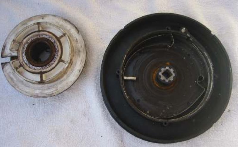

Some pics of a failed Clutch Pulley and the One-Way bearing in the Clutch Pulley Hub I don’t have a pic of the Upper Bearing ring used on this series machine but trust me it would be nasty.
Some other pics of before and after Clutch Pulley/Upper bearing ring clean up. Keep in mind if you may have to replace the Clutch Pulley Assembly and consider doing a Tub Seal replacement and Outer Tub bearing rebuild.

Large Wrap Spring 1.jpg (47.9 KB)
DSC0Series 10 Clutch lots of powder in the hub large wrap spring removed..JPG (80.7 KB)
Series 10 Upper One-Way Roller Clutch ring before clean up..JPG (36.4 KB)
Series 10 Clutch lots of powder all cleaned up..JPG (47.9 KB)
Series 10 Clutch hub mounted One-Way Roller Clutch bearing plate all cleaned up..JPG (31.8 KB)
