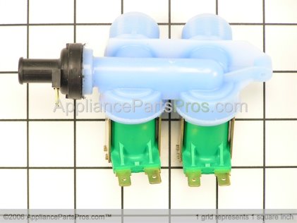

Here is the part you may need to replace.
AP6006345

Bummer.. Wrong part… :frowning:
good news is the right one is 50 bucks cheaper ($32 instead of $81) :slight_smile:
Its only two blue relays. Not four like that one you recommended and I ordered.
Its part #2 in the sub diagram that says “Series 93 and forward”
http://www.appliancepartspros.com/sect/p/x/v/pxvb5jaha1.gif
My serial number starts with a 97 so maybe thats the indicator.
This one is what mine looks like:
Part Details - WHIRLPOOL Termistor, water valve, part number: AP4029160
I just ordered the part… so Tuesday I should know…

I hope it is still this relay above and NOt the water pressure sensor?? Just asking because it seems like a change in water pressuRe makes it work, however, the humming noise seems to come from the area of the valve assembly and I think the pressure sensor is much lower and different location. The valve assembly is INCREDIBLY easy to get to with two bolts and it pulls right out the back with no other disassembly needed - so it would be a real blessing for this part to be the fix. I think the pressure regulator part is not so easy to get to.

Well good, yes the series you have does require the simpler and less expensive part.

SUCCESS!
All fixed. Working great now… a snap to replace through the little receptacle area in the back. Gotta love this experience…
[LIST=1]
  • Remove a couple screws
  • pull the metal mount plate with valve assembly out the back,
  • remove the single screw holding the valve assembly to the metal mounting plate
  • remove the electrical connections (note where they came from!)
  • loosen the metal collar that holds the water hose to the assembly
  • remove the valve assembly and replace the assembly with new one
  • Reverse the previous steps and three screws later you’re back in business.
    [/LIST]
15 minutes start to finish.
