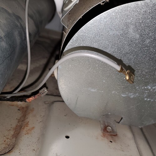

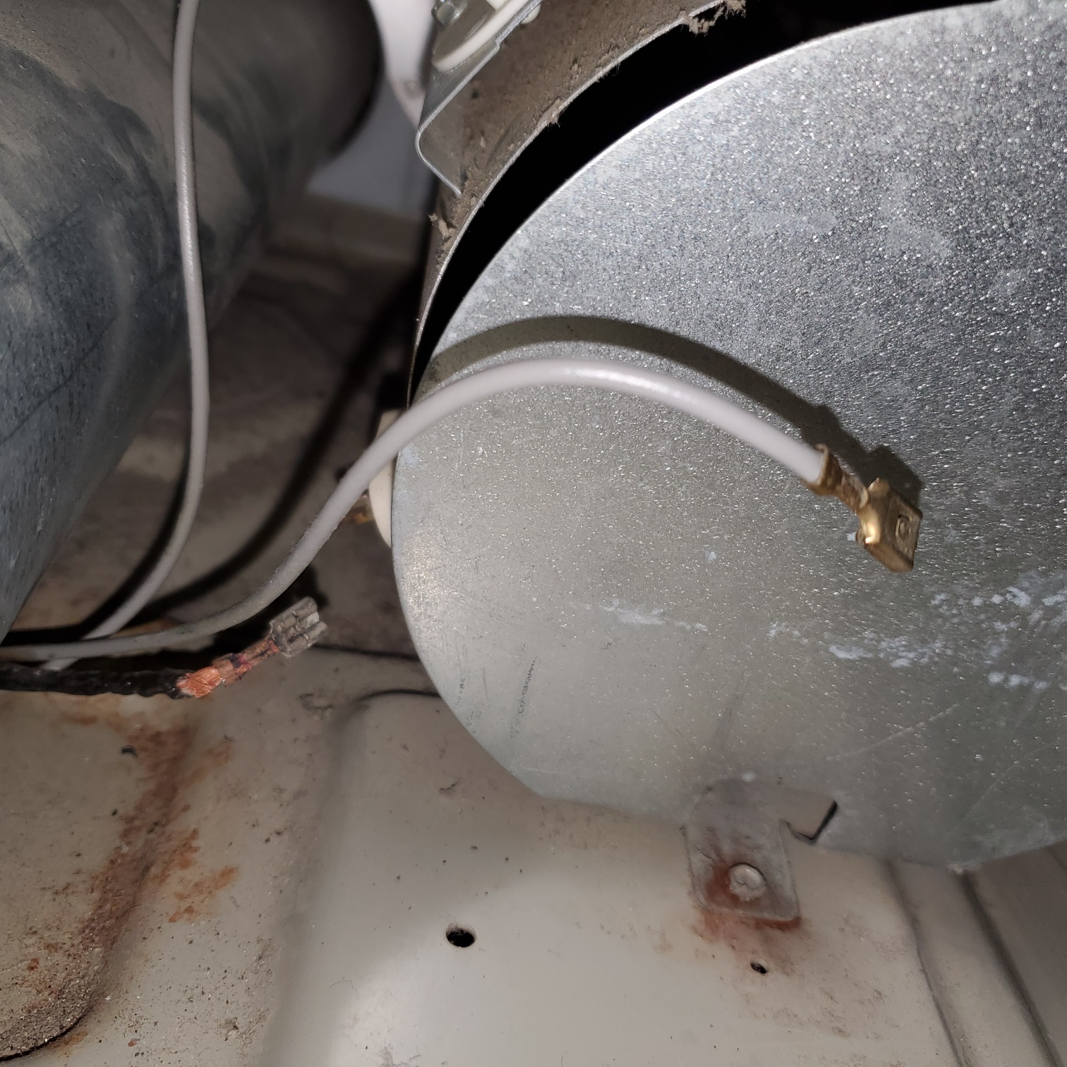

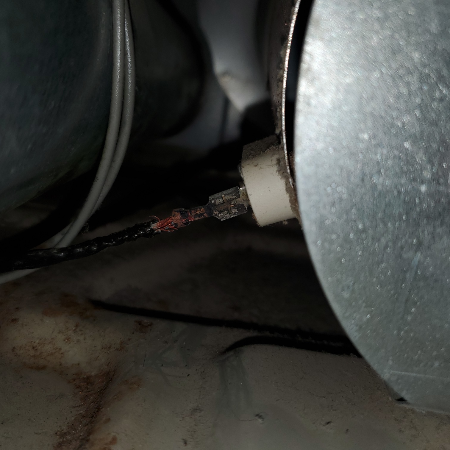

I did find and repair a black wire coming from motor to heater that was breaking away from spade connector and melted into a grey wire off heater thermal fuse. Repaired grey wire too.
Which heater thermal fuses contact should grey wire #25 attach to? Front or rear? I’ve tried both ways with the same results.
