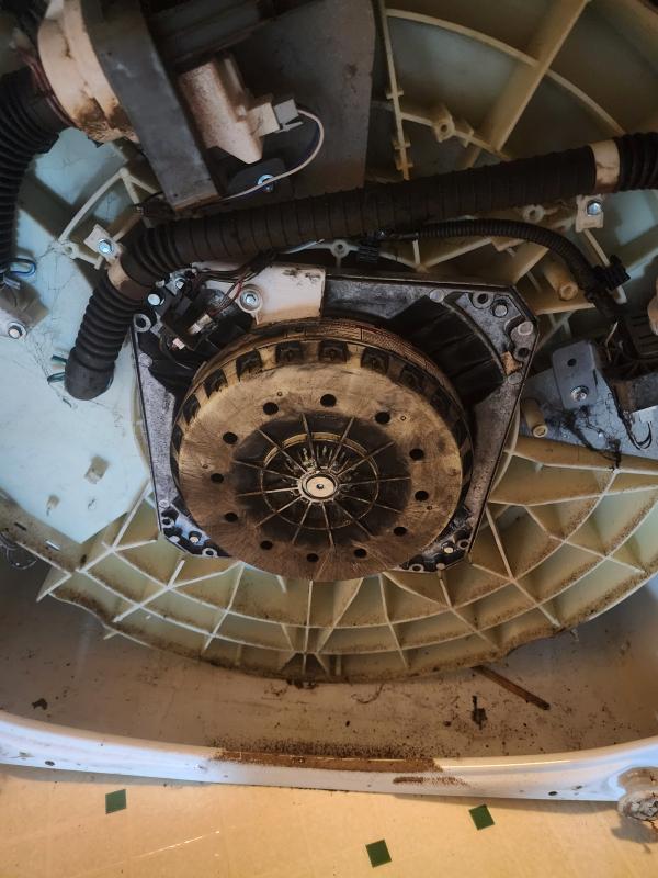

Main Symptom: OFB with Agitation Noise (Grind)
What happens & when: typically 22 or so minutes in does the OFB Error Appear

Did a average of 2-3 loads a week maybe 4 in the summertime. Last year (about 8 months really) have not used at all as it stopped working with the constant OFB error. Whether full or empty with clothes. I have done numerous tests and went all the way to empty testing. OFB error always displays at the 22 minute remaining mark. Unit seems to agitate still but one can hear a clicking noise/border line grind during agitation cycles/spin cycles. Agitator Cap likes to pop off on occation as well.
I am thinking the above list of replaced parts for this washer has been fairly excessive for the short time I have owned this appliance. The last washer was a Whirlpool front loader. The wife wanted something bigger and it came with the house from the last owners. They had a large family but it appeared gently used as their kids had long moved out. So we used it for about 10 years only replacing a drain pump and door seal. Sold the unit along with our dryer (Samsung) as a working pair.
I am going to tear into this Maytag more in the next day or so (will provide images). I am thinking that the Gearcase has done a belly up. I am thinking that the noise I am hearing is the gearcase. When we moved the washer to flip it on its side there was a perfect black mark on the vinyl floor which is the exact size and position as the direct drive motor. I believe this mark is dust from the grind we are hearing. I am thinking this dust could be from the internal gearcase freeplay which is causing the stator and rotor to touch (more dust). The dust is fine almost graphite like. It washed off the floor very easily…almost wipe it off but was fairly thick.

Looking at the picture you provided and the symptoms you’re describing, I’m fairly certain that either the rotor and stator assembly ( W10754161 Motor Rotor | Genuine Whirlpool OEM In Stock ) ( W10754158 Washer Drive Motor Stator | Genuine Whirlpool OEM In Stock ) , the gearcase ( W11393684 Washer Gearcase Assembly | Genuine Whirlpool OEM In Stock ) , or possibly both have failed. These units are notorious for gearcase failures.
At this point, deciding whether to repair or replace the washer is really a judgment call. However, if it were my machine and I had the means to do so, I would replace it rather than invest in a major repair.
The washer you’re considering is also a direct-drive model that uses a rotor and stator system. The best recommendation I can give is that if you decide to purchase the new washer, consider adding an extended warranty plan. In many cases, the warranty pays for itself the first time the unit requires a major repair.
Jeffrey_S_APP_Team,
I can tell you at this point that the Motor Rotor is shot. The inner cone that slides into the Gear Case has broken off fairly cleanly. Only a small nub remains and the rest of the cone is stuck in the gearcase. The stator is very dirty but appears to be in one piece but I will have to clean it up with IPA and rag as its covered in that dust/graphite type material. I do not currently see any deep scoring from the Motor Rotor hitting the Stator which is very surprising to me based on the carnage to the Motor Rotor. The clutch and Washer Brake Assembly came off without a hitch (The ring clamp).
