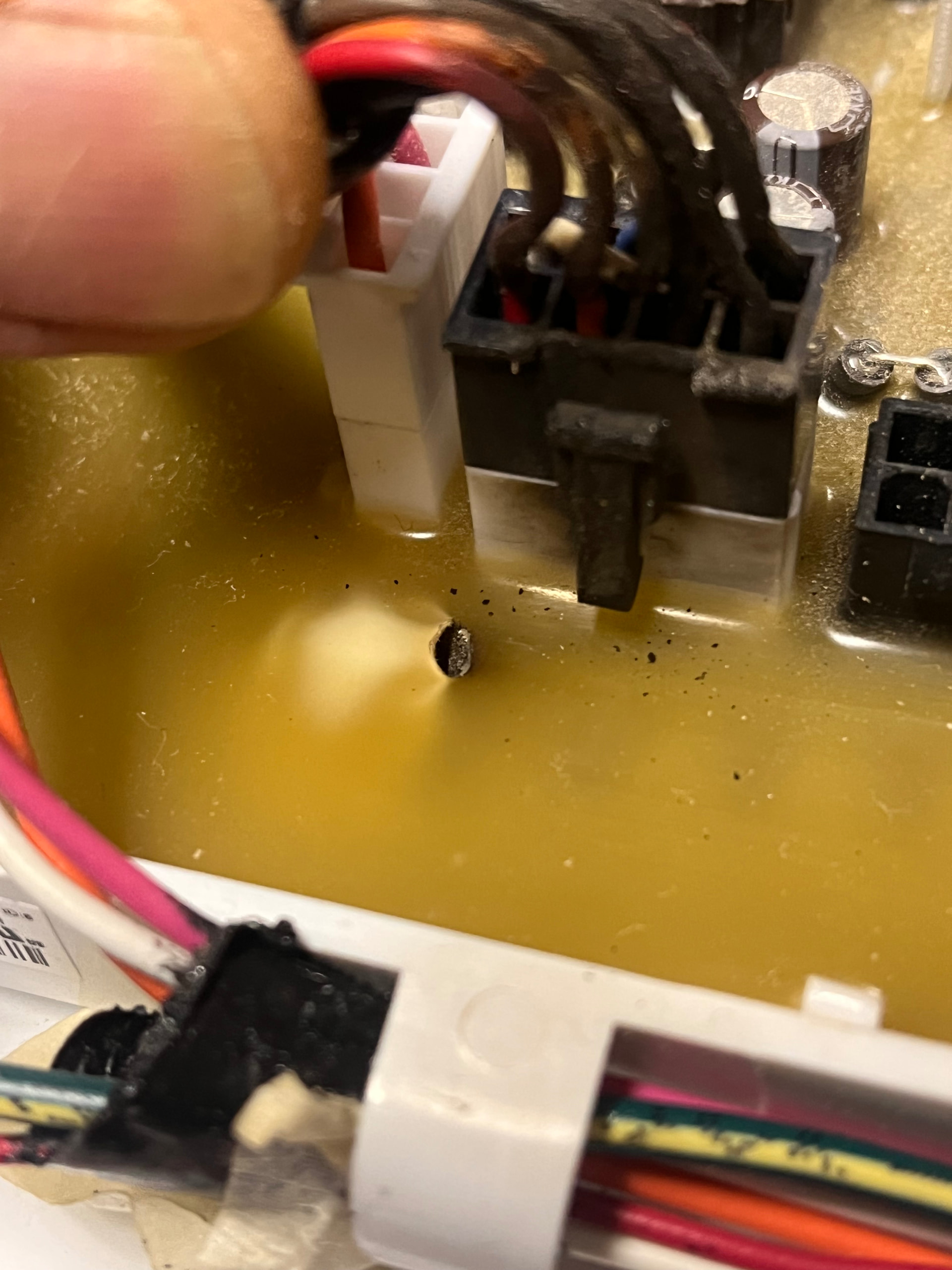

What happens washer will go into sensing then agitates then try’s to spins but goes to wash complete
F7e3, f6e3, f7e4, f7e7
Error Code (if any):F7e3, F6e3, f7e4, F7e7
Parts or tests already tried:trans replaced and shifter replaced

Thanks for the reply I tried the clean cycle nothing changed, the agitator tries to spin but only slowly and not smoothly. I ordered the main control board as I see under the touch panel it’s got a burn mark potentially its the board bit I’ll look at the harness as well. Do you know if a good way to test that with an ohm meter? This is what I’m finding. I had read some where on here a larger weakend or not working capacitor can be replaced and could cause this problem in the board
There are no tests like that for this board on this issue. If the board is damaged it needs to be replaced, there are no indi9vidually serviceable parts on that board. I would suggest replacing the harness as well.
