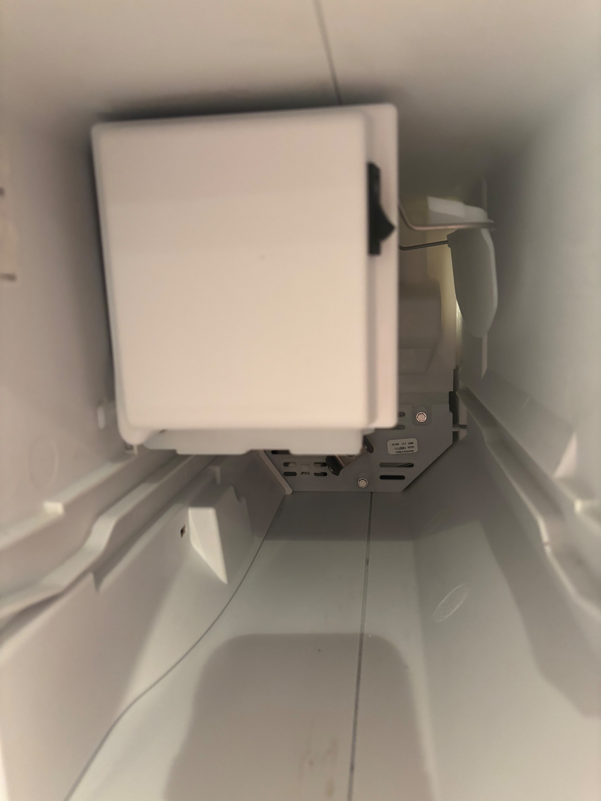

**What happens & when: The refrigerator suddenly stopped making ice completely. Last week I purchased from Appliance Parts Pros a new IceMaker Kit (**Part #: W10583817 (AP5688861)). I installed it yesterday but still no ice. I do not think water is coming into the ice maker. The water dispenser for drinking works fine and the pressure seems good.
The most likely cause for this issue will be a faulty water valve and will need the following part.
https://www.appliancepartspros.com/whirlpool-valve-dual-water-67006322-ap4081950.html
Ordered and installed the water inlet valve with no issues. However, no ice still. It’s been 36 hours. So I’ve replaced the ice maker kit and water inlet valve. One thing I noticed was the ice shut off metal bracket seems high. I tried to gently pull it down but with no luck. I also have not heard water pouring into the ice maker. The cup water dispenser works fine.
