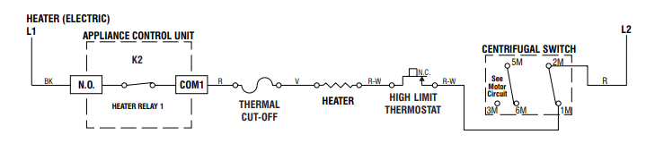

Maytag MED6230HW2 Heating Element Wiring
Brand:Maytag
Model Number:MED6230HW2
Main Symptom: Heating Element Wiring
Parts or tests already tried:replaced heating element but I forgot to take a picture of the wiring before I disconnected it and now I’m worried about reconnecting incorrectly.
Hello, here is a ladder diagram, hope it helps.
My dryer has a red and a red W/white stripe coming from the dryer plus a red jumper and a black jumper. I’m sure the diagram would help if I could read it correctly.
