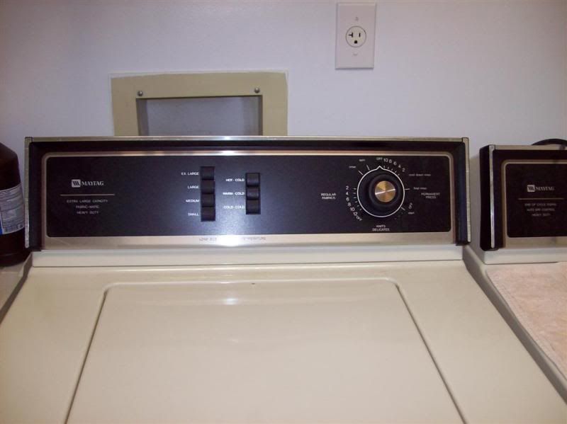

I have a Maytag Model LA8650 Washer that I purchased in 1991. It has never given me a day’s worth of trouble until recently. During the spin cycle, it makes a terrible grinding/rattling/scraping sound. Sometimes it sounds like there are loose metal parts rattling around (like loose bearings or something), but not all of the time. It also seems to get off-balance very easily - even when the load is balanced . If you notice in the video, it gets off-balance even with nothing in the washer. The rasping sound is intermittent as you can also hear. Then it makes a different sort of grinding/rattling/scraping sound as it stops spinning.
I checked the belts underneath and they seem fine. I can turn the belts by hand. I can find no evidence of any leaks. It washes clothes fine, does spin, and does drain the water fine. It doesn’t leap or bang around. The only problem is that it makes that horrible noise during the spin cycle and stopping the spin cycle and both noises are definitely different/new than in the past.

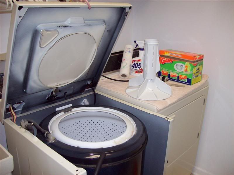

I am following your advice and working to remove the inner tub. I am following the instructions posted here: http://www.applianceaid.com/tub_seal_replacement.html
I have removed the front panel, unscrewed and lifted the top cover with lid, disconnected the water tube on left side of top cover, removed the metal band from around the tub, removed the agitator screw and removed the agitator. I can lift up the tub crown (tub cover/lid) but have not yet removed it because I have not yet disconnected the injector tube.
So I am at Step 10. It appears that this is the step where I really become committed because I have to: 1) buy parts - the spanner wrench, and 2) most likely break the spanner nut to remove it. In another forum, it was suggested to me that I need a bearing and seal overhaul, which I believe is performed using the same set of instructions. So I need more advice. Can a semi-intelligent, semi-mechanical woman complete this job, or does it take a lot of muscle/strength? (go ahead, make your jokes!) Also, is it worth it on a washing machine this old? (Or a woman this old? haha!) Will I be able to remove the spanner nut so that I can remove the inner basket?
Here are photos showing current status:
you may not need to replace any parts at this point .just remove tub first.
I’m down to the inner tub/basket. I am waiting on the spanner wrench. Will report back as soon as I get it.
The spanner wrench, Washer Tub Bearing Kit (Part 204013), and Washer Mounting Stem & Boot Seal Kit (Part 22204012) all finally arrived. Got busy with the spanner wrench. I’ve whacked it around and around the center post with the rubber mallet. Must have slowly made three or four full circles. But the nut still does not spin freely. Yes, I am going in a clockwise direction. I can tell that it has unthreaded somewhat because the inner basket now spins easily. But it looks like I have a long way to go to get the nut off. How many times around will I need to go with the spanner wrench? Every time I walk by, I whack at it until I am tired. Is there any risk that I am stripping the threads? Or is this proceeding as normal?

keep at it till it comes off, yes clockwise
I finally finished the job! Remaining procedures, installation and numerous photos are posted here:
