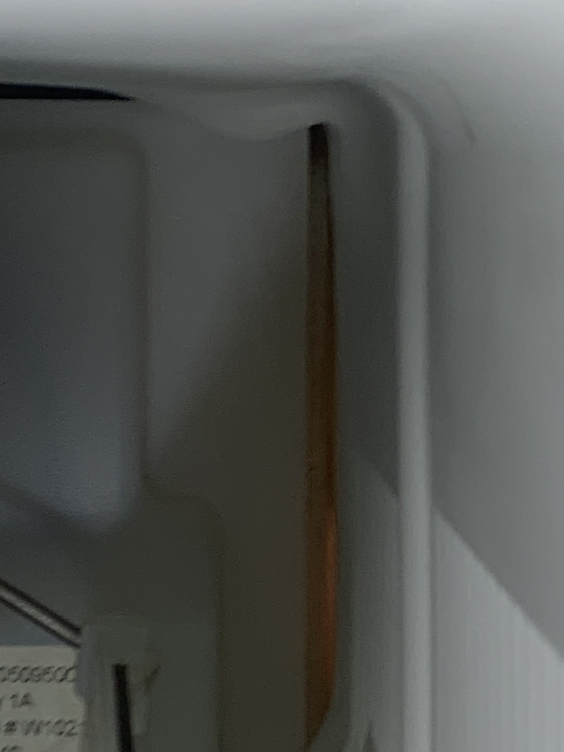

I have a Maytag French door unit #MFI2269VEM11. The ice maker froze over; there was ice under the ice bucket, etc. I cannot pull out the ice maker unit, as there are bumps (see arrows) that block its removal. I assume these bumps should not be there. There is water and some ice in the unit. As I cannot pull the ice maker unit out, I do not know how to proceed.

Could you upload the photo showing the arrows pointing to the bumps? I’d like to verify exactly where it’s hanging up. Also, after you thaw it, let me know:

The second photo has the bumps. I’ll upload it again.
  • I used a hairdryer to melt the ice and remove the ice bucket.
  • I removed the side panel and disconnected the harness
  • I pushed the release tab, but I can only get the ice maker unit to move about 1/8" to 1/4" before it hits the bumps.
Here is the 2nd photo with the arrows:
Here is a new photo of the bump on the bottom:
And here is a new photo of the bump on top:
Thank you again!
All the instructions I can find say you should be able to maneuver the ice maker past the bumps once the harness is unplugged
Unfortunately, as you can see in the photo below, the red line is the edge of the ice maker unit and is behind the “bump”.
I saw a post that claimed bumps are caused by ice from a freeze-up.
I believe the unit is overfilling, spilling water that becomes ice all over. There was also ice coming out of the fill tube into the unit, which may be causing water to go around the ice box, and thus causing the bumps on the side.

If you want to remove the ice maker, you’ll first need to melt the remaining ice that’s holding it in place. A hair dryer works well for this. Once all of the ice has melted, gently warm the plastic bump that’s blocking the ice maker. As it softens, you should be able to press it back into place enough to carefully work the ice maker past it.
As for whether the ice maker is still good, that depends on whether the overfill damaged any of the electronics. Once you’ve removed all of the ice, you can test it before replacing any parts.
Turn the refrigerator’s water supply back on just long enough for the ice maker to complete one fill cycle, then shut the water supply back off so it can’t continue to overfill. If the ice maker freezes the water and harvests the ice normally, then the ice maker itself is likely fine, and you’ll only need to replace the water inlet valve(s), since they’re most likely leaking by and allowing water to continue dripping into the ice maker.
On your model, the water inlet valves are located inside the fresh food compartment behind the panel below the water filter housing. To access them, remove the water filter cover, then remove the rear panels in the fresh food compartment. That will expose the inlet valve assembly for replacement.
