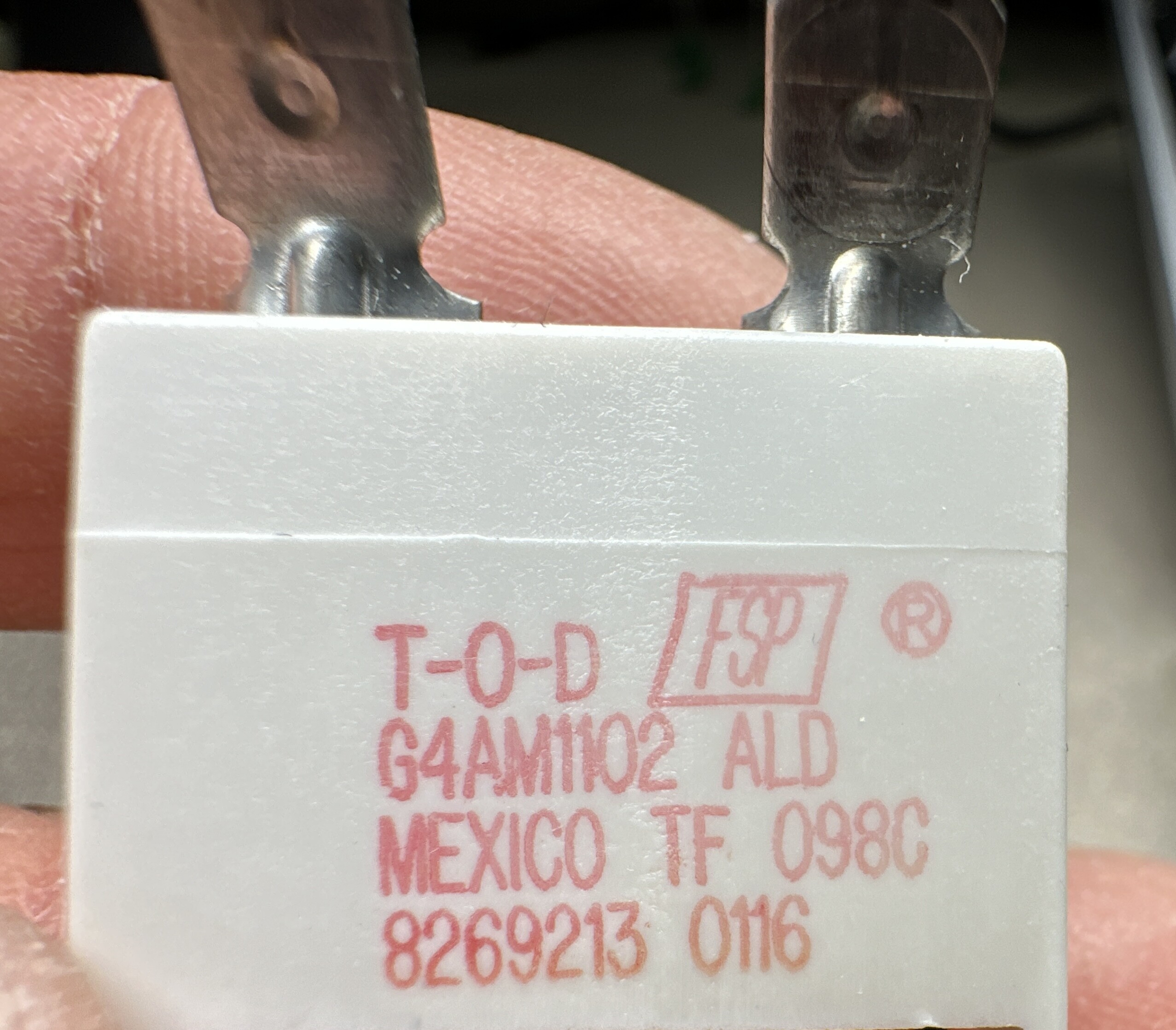

I think the problem is heater relay leg at control board maybe loosing contact, or any other bad contact and resulting heat at that location traveling along wires. If you carefully look at the board you may notice brownish spots indicating overheating. Carefully take board out of the plastic tray and look at the back where all the soldering is located.
While current continues to run (~10A when heater is on using clamp meter), extra heat due to the charred contact (high resistance) generates extra heat that gets carried along copper wires (best thermal conductor) to the thermal fuse, and takes it over the edge.
Manufacturer of the thermal fuse mentions this as well, refer https://www.emerson.com/documents/commercial-residential/product-information-application-notes-en-us-3579620.pdf (p. 10 shows problem fuse 8269213) on page 21: "Splices and Terminations: Insecure splices and terminations may produce high resistance junctions which can cause self-heating (I2R) as power is dissipated across these junctions during product operation. Heat from these areas can flow down the thermal fuse leads and increase the temperature of the thermal fuse. ". I could confirm the problem with the thermal camera - fuse leads were hot, and touching them (metal part) burned my finger - the most scientific examination! The repair kit implies the heat source is at the fuse terminals, and requires cutting these off, and replacing with supplied new leads. In my case it was heater relay. To repair relay, check P/N at DegiKey (T7CV5D-24) there is a substitute P/N since it is no longer available : J107F1CS1524VDC.80 CIT Relay and Switch | Relays | DigiKey
