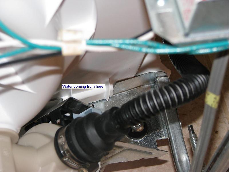

I replaced the control board and now the drain pump runs only when it is supposed to. Thank you. However, during a rinse cycle something was leaking water on to the outside of the drain pump, which I suspect is what caused it to fail in the first place. The trouble is I can’t see what the leak is coming from. There is no seal there to spring a leak, there is no crack in the tub, etc… Attached is a picutre of the drain pump and the location of the mystery leak.
It’s very hard to pinpoint water leak by viewing this picture. If you can remove the dishwasher from the cabinet and run it through a whole cycle monitoring this part of the dishwasher, then it might help you to determine where it’s leaking from.
