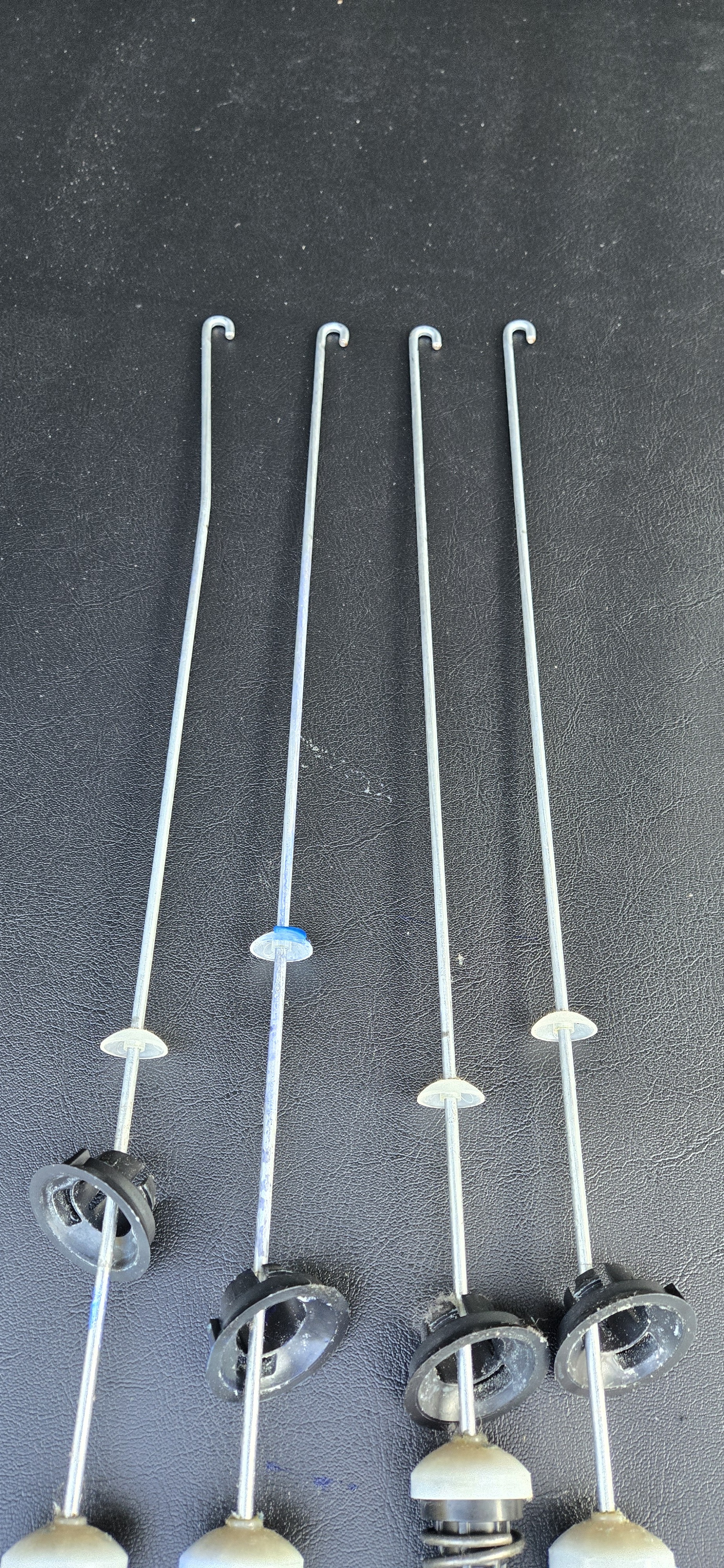

We were having some severe unbalanced load issues with our Maytag Direct Drive washer (MVW7232HW0) so I replaced the suspension rods, finding one to be bent. Culprit found, right? So I thought… The issues went away for a few weeks, then steadily worsened. As I had replaced the suspension rods before with cheap, aftermarket rods off that jungle-named retail website, I decided to go with OEM. This took care of the issue for a while, but it has steadily gotten worse again.

In the meantime, I am wondering if the balance ring IS the culprit. When I initially replaced the suspension rods, I reported there definitely was one that was an issue. I am wondering if the shaking and unbalanced issues that occured prior to that rod being bent (or the damage to the rod happened because of) came from the balance ring having issues or whatever culprit it ultimately ends up being. For fun, I’ve included a picture of those rods from back when I replaced them.
When replacing the suspension rods, I replaced all bushings, etc. Both when I replaced with the aftermarket kit and the OEM kit.
