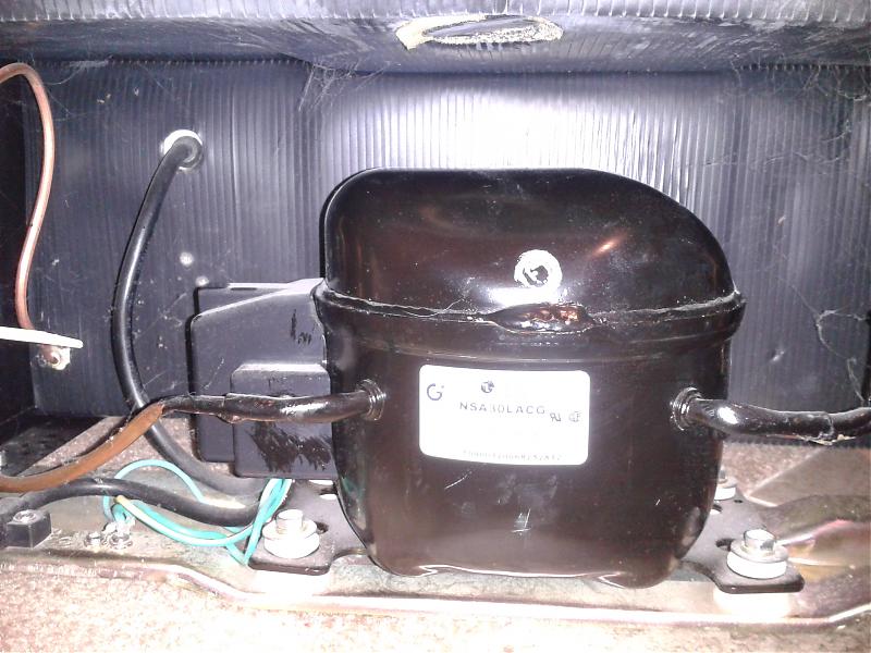

I have a Magic chef mcbr445b1 refrigerator.
The other day I opened the door and the beverages were warm and there was no cold air. I unplugged the unit ad waited 20 minutes, plugged it back in, and set the dial to 7. I waited 15 minutes and the fridge did not cool down.
I checked the back and the compressor (# NSA30LACG) is warm See attached.
I am not that savvy when it comes to electrical items. I am guessing the compressor is ok?
I am not sure what the next step is.
Any help would be appreciated.

Looks like this a small 4.4 cu. ft. compact refrigerator.It’s not expensive (less than $200) and I believe it’s not worth any repair.
It cost about $180.
What could be the issue?
Wouldn’t the parts be lest costly than a new one if I can figure out the issue and do it myself?
Check the compressor on touch. If it’s working, it should vibrate.
I plugged in the refrigerator. The compressor gets very warm but it is not vibrating that I can tell..
Sounds like there is something wrong with the compressor. If it’s right then it’s very expensive.

It is always in my best interest to help people save money. In this case, it would cost significantly more to repair the refrigerator than to replace it. Just the cost of the compressor, not including installation, would be at least $200, which is more than the cost of buying a new refrigerator. As always the decision made by the owner.

Your refrigerators, gas is over, so you have to refill it.
