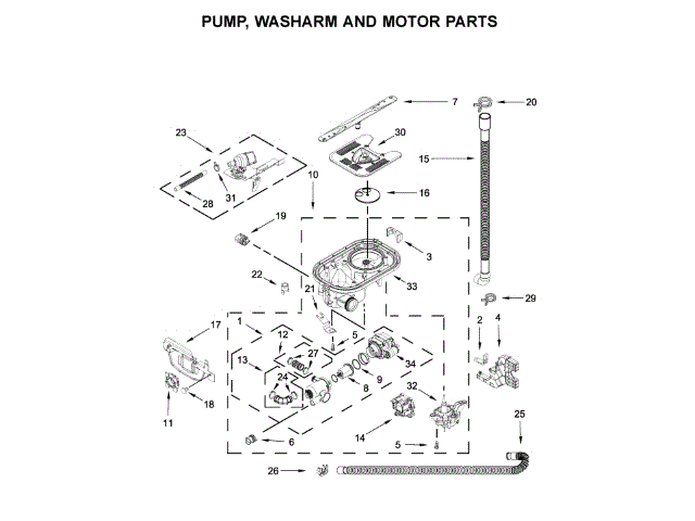

https://click.linksynergy.com/deeplink?id=QxJAh16ZHqc&mid=13810&murl=https%3A%2F%2Fwww.appliancepartspros.com%2Fparts-for-maytag-mdb9959skz0.html
#7 is the lower arm.
#16 is the diffuser.
#33 is the pump base.

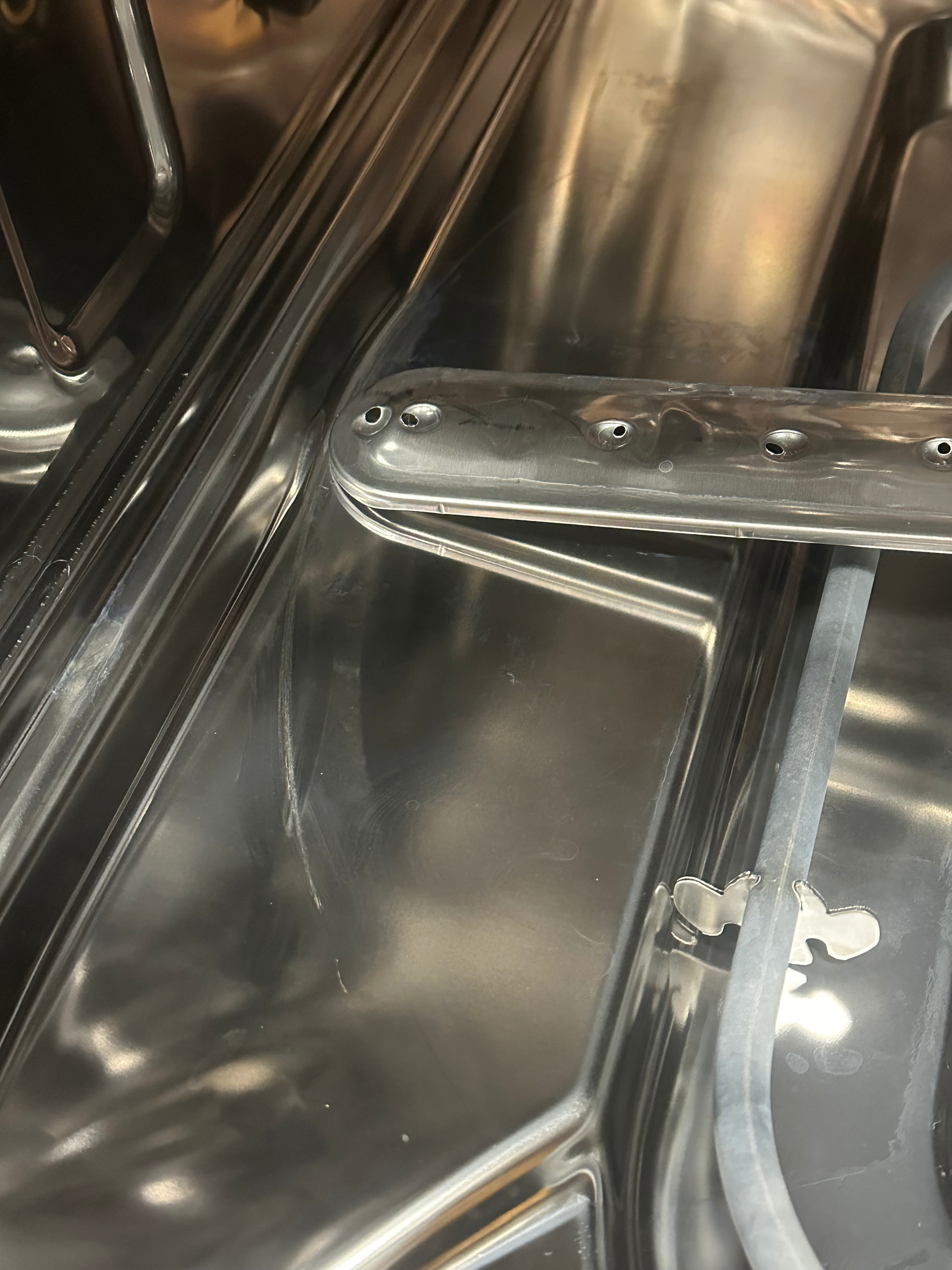

Would you be able to provide a picture of the lower spray arm and where it is hitting? A spray arm can have some wobble, but it should not be enough to hit anything.
Not too good at posting a pic on here but I gave it a try. Let me know if that worked. You can see the marks on the bottom where it has dragged and seems to stop in the same area when it’s finished washing.
Either the lower spray arm is damaged at the mounting stem, the lower spray arm is loosely connected to the diverter plate, or the diverter plate has been damaged and is allowing the spray arm to sag like that.

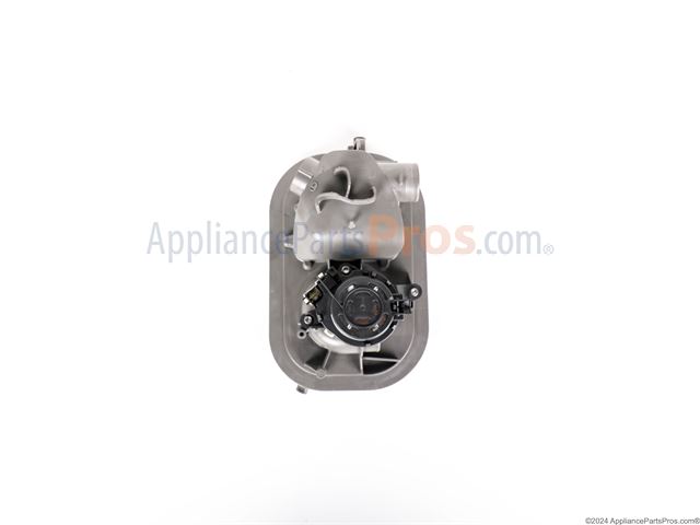

I found nothing separate, just the sump assembly complete…
LINK> Whirlpool Sump OEM Part

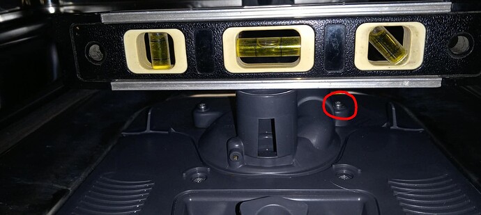

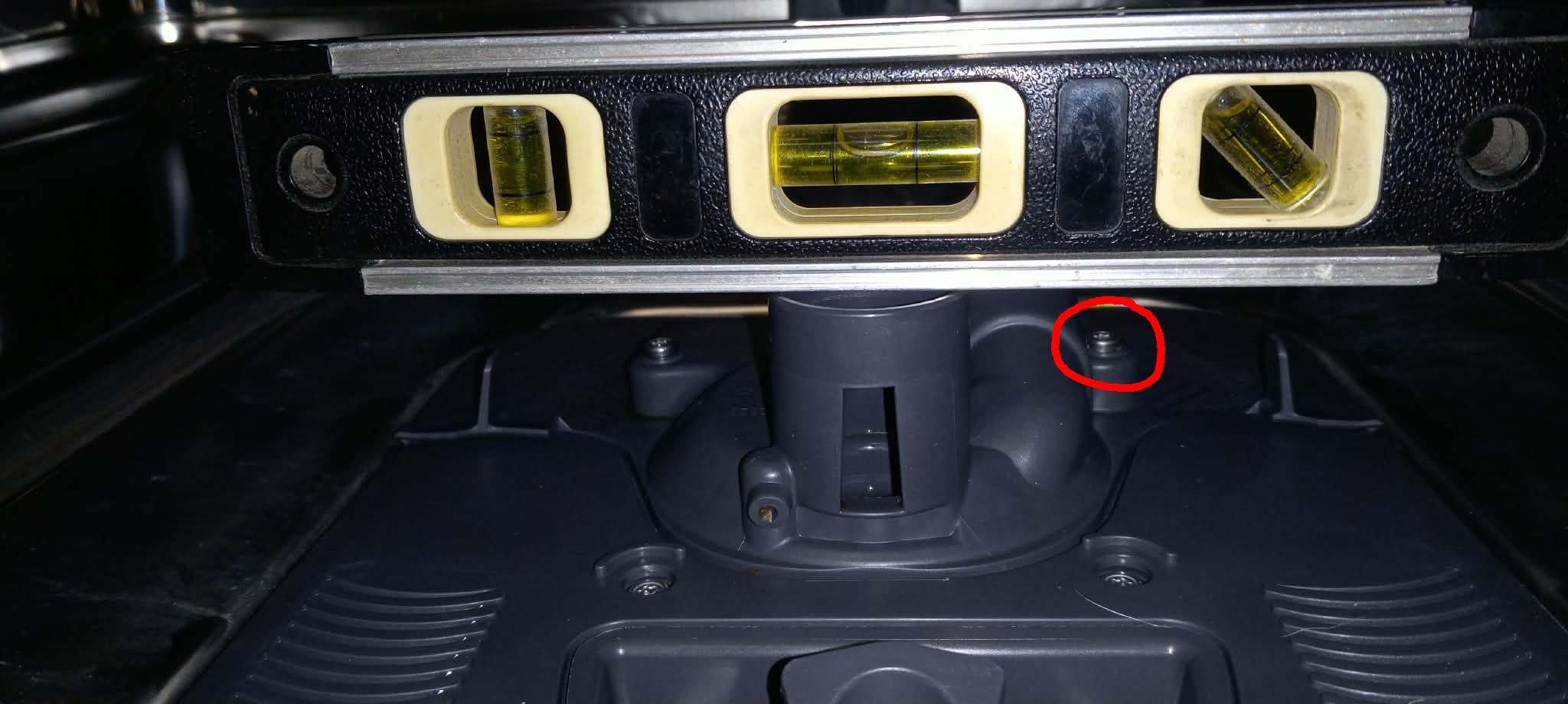

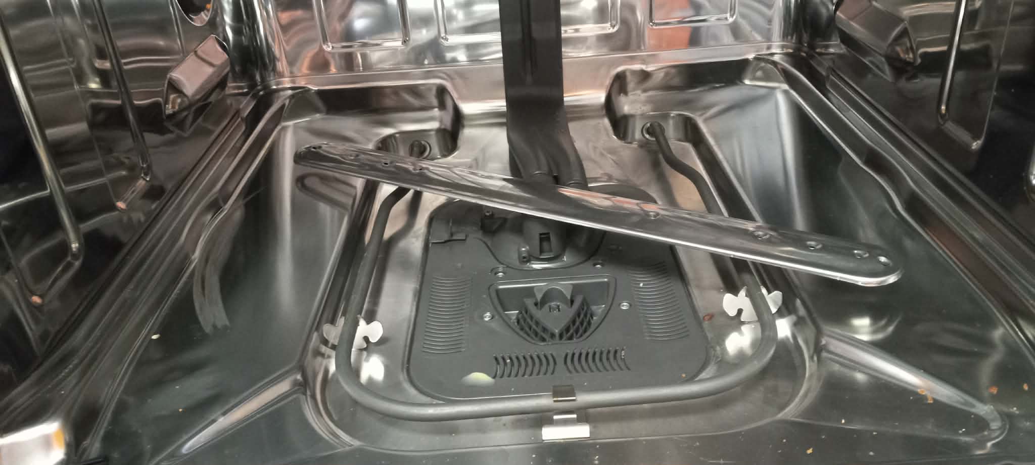

Did you resolve this? Ours (Maytag MDB4949SKZ0) does the same thing. There are wear marks on the left side. I replaced the spray arm, but the problem still exists. The dishwasher pan is level. I’m not seeing any cracks or warping or anything, but it appears to be little wiggle room between hitting the basin or the lower rack with as sloppy as the spray arm is when ‘seated’.
I’m hesitant to buy any more parts without trying to identify the cause
If you remove the spray arm, does the base look like it might have stretched out at all? From what I can find, the port for the spray arm should be about 1 1/2” in diameter.
It does not. But I put a level on top of that spindle and it was way out of whack too high on the right side. I can’t believe I didn’t notice it before (Damn my aging eyes) but the rearmost right side torx bolt was completely backed out?! Not sure how the hell that happened, but I tightened it down and wallah! Nice and level like it should be.
Very odd, as I have never worked on that before… There was a crew that came out and did some recall work on the heater bar a few years back and perhaps they never tightened it back down? But the rubbing and knocking just started a few months ago… must’ve just needed to take a while to back out.
Thank you for giving me the idea to check that spindle more thoroughly.
