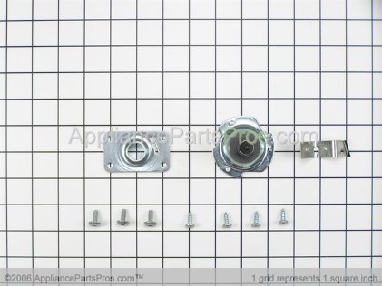

I have a GE Profile dryer that has recently become very loud. At first, it would get very loud for the first couple minutes, then it would quiet down, but now it is just constantly loud. It is not a squeaking sound, like I have seen others mention, and I wouldn’t call it a grinding sound, though I suppose it could be. Dryer works great otherwise, so hopefully it is a relatively easy fix.
Any ideas? Thanks!

Actually this is a picture of the glides in the front, there are four of them. If the noise is in the rear, you need the rear bearing kit. Tom ApplianceEducator.com
Here is the picture of the rear bearing kit. Tom ApplianceEducator.com
