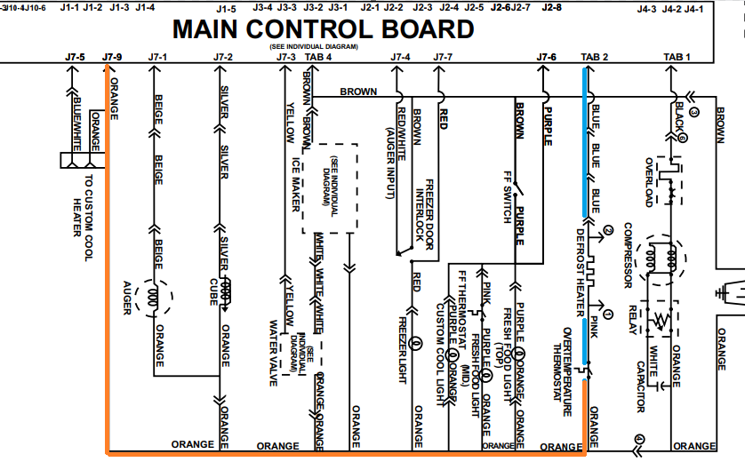

GE Profile Arctica PSC23SNGA Defrost issues. I am changing the evaporator fan because it tested low. I’ve checked many other items with the mulitmeter, so far ok. QUESTION Testing for ohms on the defrost heater and bimetal line is it ok to get slightly less… my reading is 19.8. Is that bec older control board? or does it matter? I am thinking of switching out control board as well, though most of it is testing fine. I am also curious how to test for a wiring problem between bimetal and control board? Would the 19.8 ohms be a natural degredation for the control board? ALSO i lost my service tech data sheet. Is there anyone with one or where can i find it? thank you

Would it be possible to send a picture of the model and serial tag? Unfortunately, several different models come up with the model number provided. If the tag shows PSC23SGNA, this diagram can be used as a reference. The defrost circuit would be tested from the blue wire at Tab 2 to the orange wire at connection J7 pin 9.
