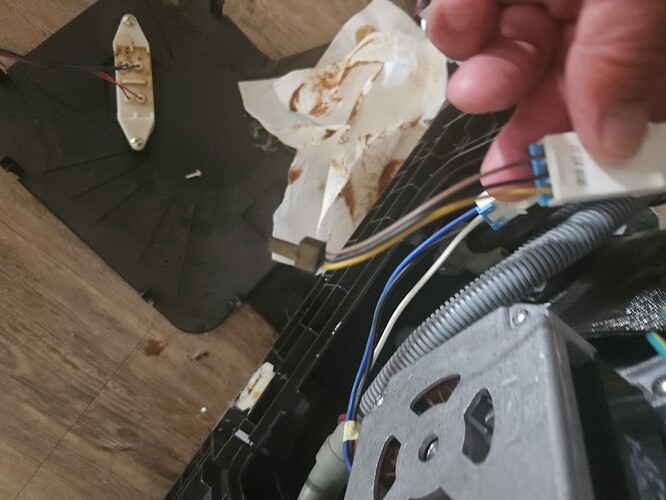

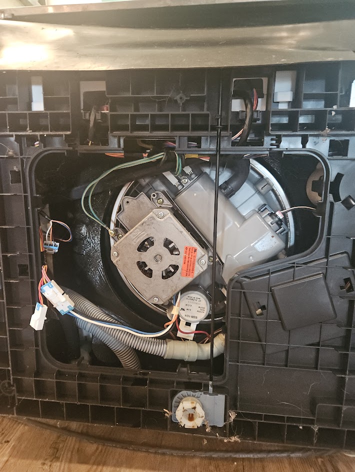

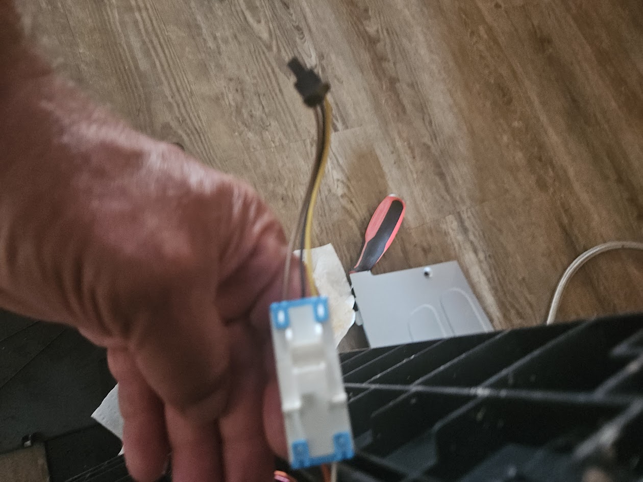

Hello.
I repalced circualion pump in this diswasher but while putting it back together found this wire end. I took pitures prior to unplugging any wires but do not remember this one. Can anyone tell me where it might connect to?
See if this service manual helps:Dishwasher-24.pdf
On the other side of the connector there is a white wire and what looks like an orange wire. Is there a third wire on that side of the connector and if so, what color is it?
White, orange and brown
The white, orange, and brown wired connector would go to the flow sensor which is on the plastic case on the left of the dishwasher. Near the bottom center of the brake case assembly is a black disk and the flow sensor would go in place at the port near this disk.
