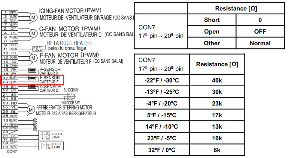

More than likely, the freezer fan is not sending the feedback speed signal to the main control board. These fans can get a DC short and this can cause not just error codes, but it can also cause the main control to not operate properly. However, the fresh food sensor and the freezer sensor can be tested to verify if they are working properly or if there might be something else going on. At the connection CON7 of the main control with the power supply cord unplugged and the CON7 connector disconnected, the fresh food sensor can be tested using the white wires at pins 15 and 18. The freezer sensor can be tested using the blue wires with white stripes at pins 17 and 20. What resistances do you find there? Here is the connector layout from what I am able to see.

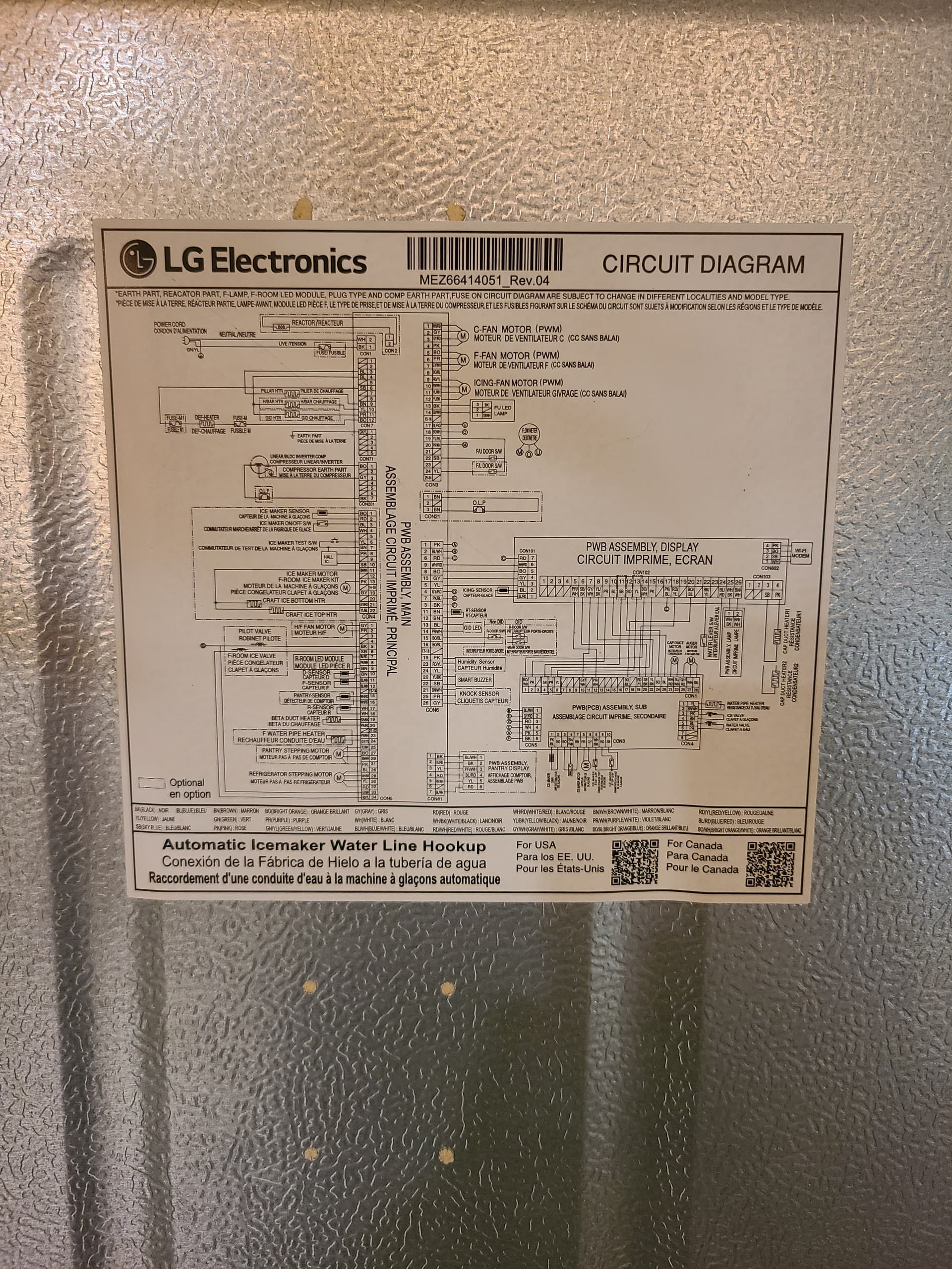

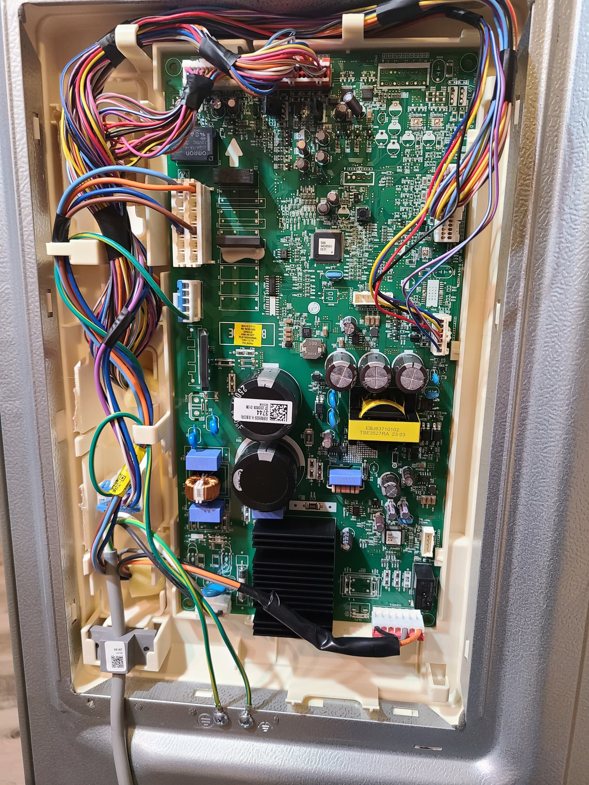

My wiring diagram and control board
The wire connection needed to be used would be CON5 with the same color wires mentioned. The freezer sensor can be tested using the blue wires with white stripes at pins 11 and 12. The fresh food sensor can be tested using the white wires at pins 17 and 18.
If I am doing it correctly the 11 12 reading is 16.5 and the 17 18 is 26.3
At the connector wires the 11 12 is 2.9 and the 17 18 is 12.1
The wires would be tested. If the reading for the 11 and 12 freezer sensor wires is 16.5K Ohms, it is reading around 5 degrees. If the reading is 2.9K Ohms, the sensor is reading 68 degrees. The fresh food thermistor wires measuring 26.3K Ohms would indicate around 36 degrees, while 12.1K Ohms would indicate around 69 degrees. If the readings do not match what the actual temperature is, there is definitely a sensor failure. This plus an evaporator fan failure would certainly cause issues. It looks like the refrigerator thermistor is only available as a part of the duct assembly. Here are links to the parts for reference.
