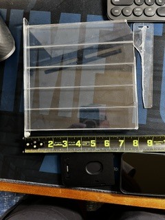

I also need the interior shelf support part that is between the two pull out drawers in the refrigerator.
It’s in section 3 on the exploded view, location 141B
( LG MJH65793101 Refrigerator Supporter Cover (Tv) | Genuine OEM Part )
out of stock but usually ships within 14 days
Thanks for all the help!!
Can you check this? It says TV cover?
It is the correct part we’ve seen this a lot with LG appliances. Something gets lost in the translation from Japanese to English
