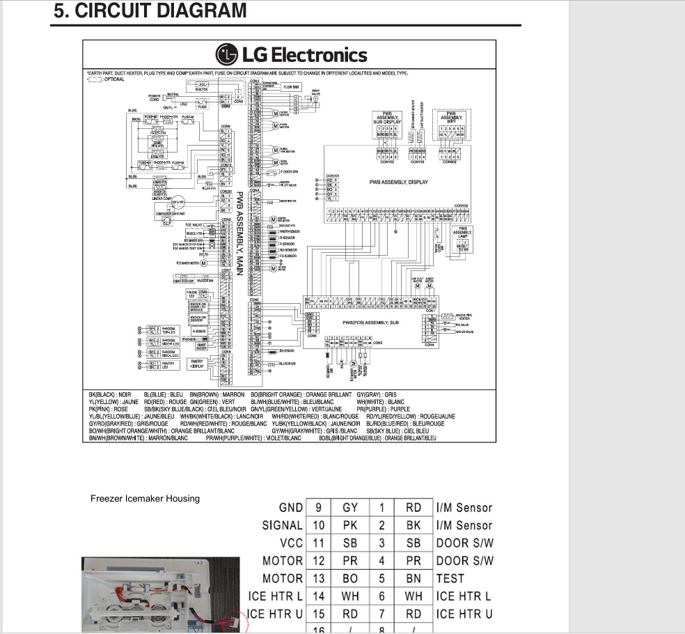

One correction to my previous answer: I don’t want to give you a pin number or voltage from generic LG information. I searched specifically for the LRFXC2416S/00 wiring/service information, but the publicly indexed material I found confirms the parts/diagrams without exposing the actual wiring schematic/pinout. So I can’t substantiate an exact connector/pin voltage yet. The model also uses a separate EBF61314816 door/magnet switch, which is another input worth considering in the control diagnosis.
Thanks so much for the great info so far, and for looking to find the wiring schematic…
I do have a multimeter, but am not sure which pins to check…

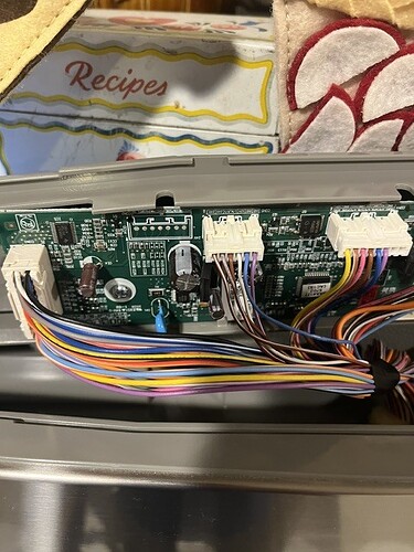

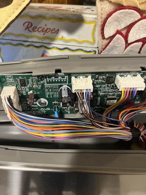

I took a look at the wiring area above the left door near the hinge. Inside that compartment is this sub control board part #EBR88124603… Just visually, I couldn’t see anything out of sorts or burned, etc…
