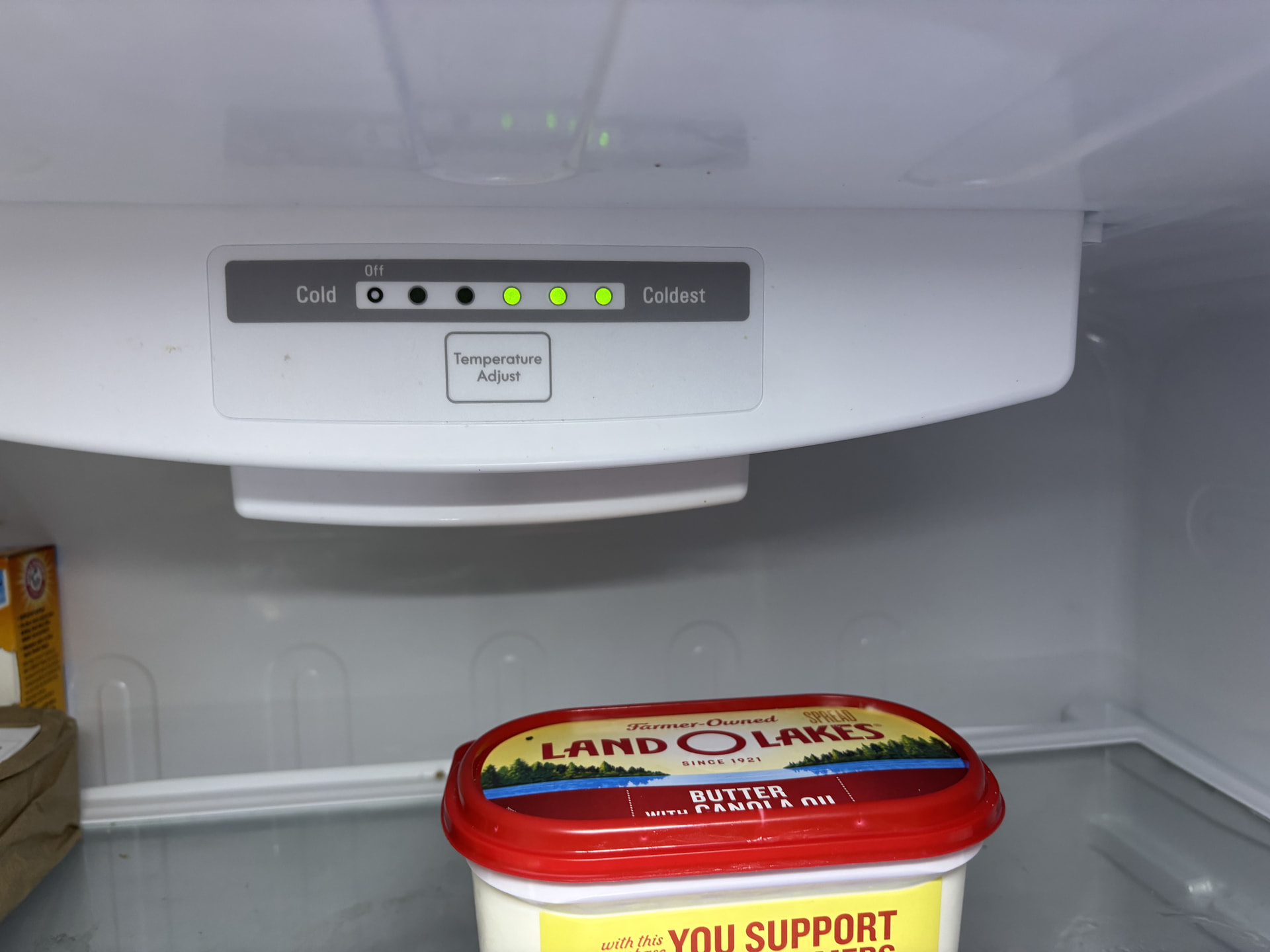

Refrigerator temp is about 45 degrees. This was recorded by taking the temp of water in a water bottle. The freezer is below freezing because it will create ice, but it’s not as fast as before. Prior to breakdown, fridge was loud/noisy and the noise would stop when the door was opened. Also, the freezer was frosty. I tried a manual reset by unplugging for 10 minutes. Then there was an unplanned power outage the next day of several hours. Temps seem colder now then upon initial breakdown, but not at the correct level.
Fridge was purchased 4/30/24.
My skill/knowledge level is probably about a 4 or 5.
Temp display only shows the last three lights instead of all five

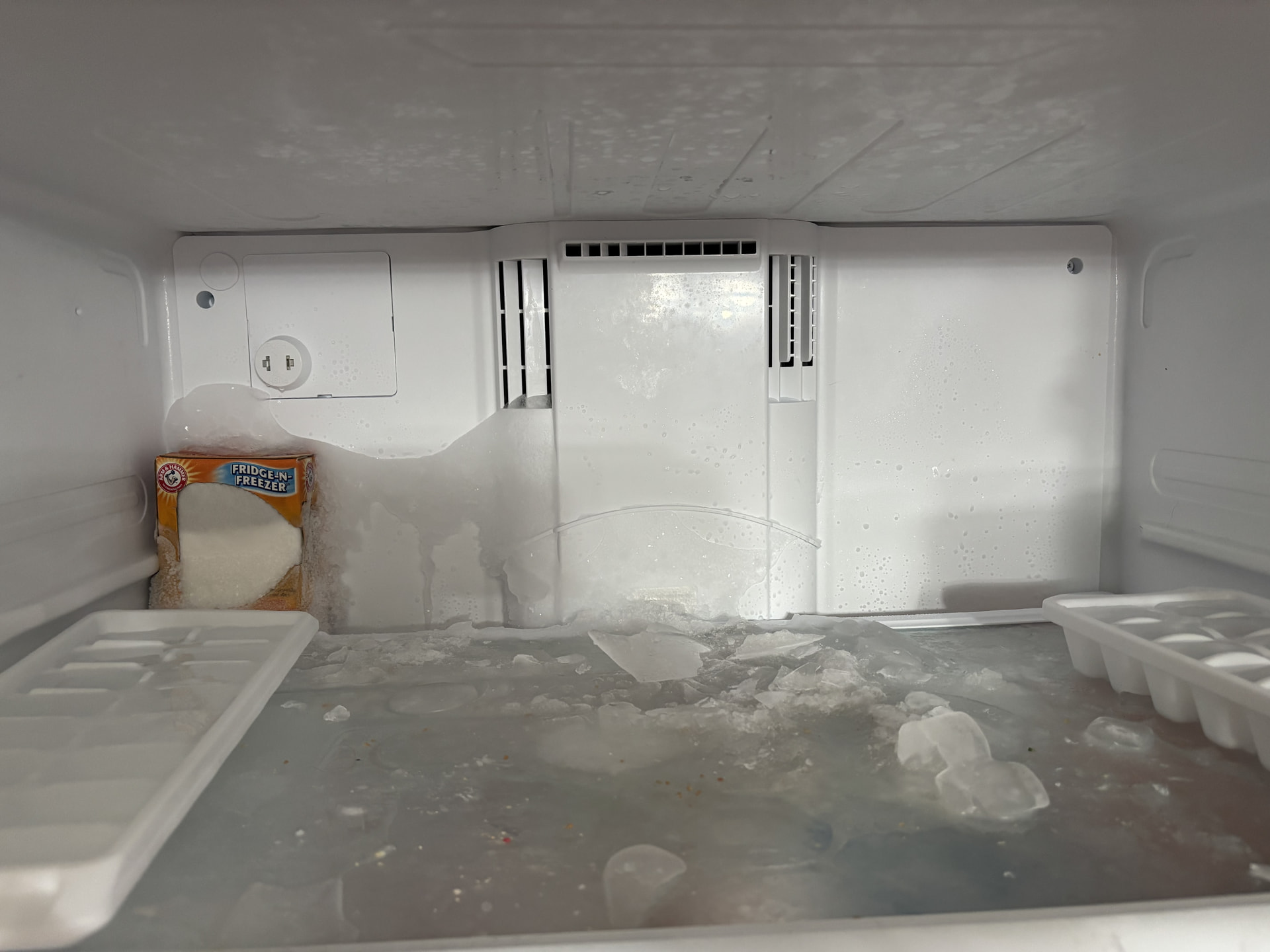

Frost was covering food and freezer walls. I checked on warranty and I think it’s only 1 year.

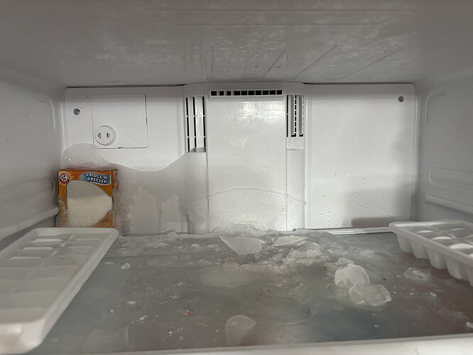

Rear freezer check 20 degrees
Freezer door 30 degrees.
There is some ice buildup on the back freezer panel.
Not at home, will update more later.
Thanks,
pdl2
Jeffrey,
Freezer door is closing completely and sealing
No switch in the freezer. I don’t think the fan is blowing
Some ice buildup

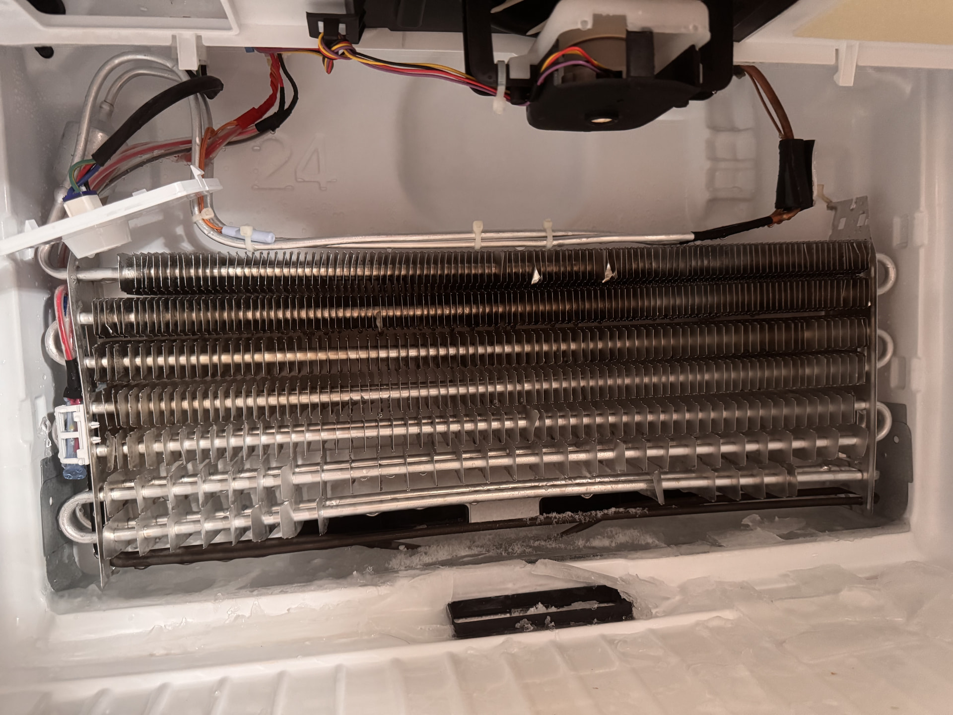

For your LG refrigerator model LHTNS2403S, the defrost heater (LG MEE64165105 Top-Mount Refrigerator Sheath Heater | Genuine OEM Part) and defrost thermostat/controller (LG ACM75378808 Top-Mount Refrigerator Refrigerator Electronic Control Board Assembly | Genuine OEM Part) are accessed from inside the freezer, behind the rear evaporator cover.
Since you’ve been seeing the refrigerator temperature around 52°F and the freezer temperature fluctuating, checking the defrost system is a good next step.
1. Accessing the defrost heater and thermostat
  1. Unplug the refrigerator.
  2. Remove the food, ice bin, and shelving from the freezer.
  3. Remove the screws securing the rear interior freezer panel.
  4. Carefully release the panel clips and pull the panel forward. Disconnect any fan wiring if necessary.
  5. You’ll now be able to see the evaporator coil and defrost components.
The defrost heater is mounted along the evaporator assembly, typically near the bottom of the coil. The defrost thermostat, if this version uses a separate one, is attached to the evaporator tubing near the upper portion.
Before removing anything, look at the frost pattern. If the entire evaporator is packed with snow and ice, that points toward a possible defrost problem. If only one small section is frosted, we may be dealing with a different cooling issue.

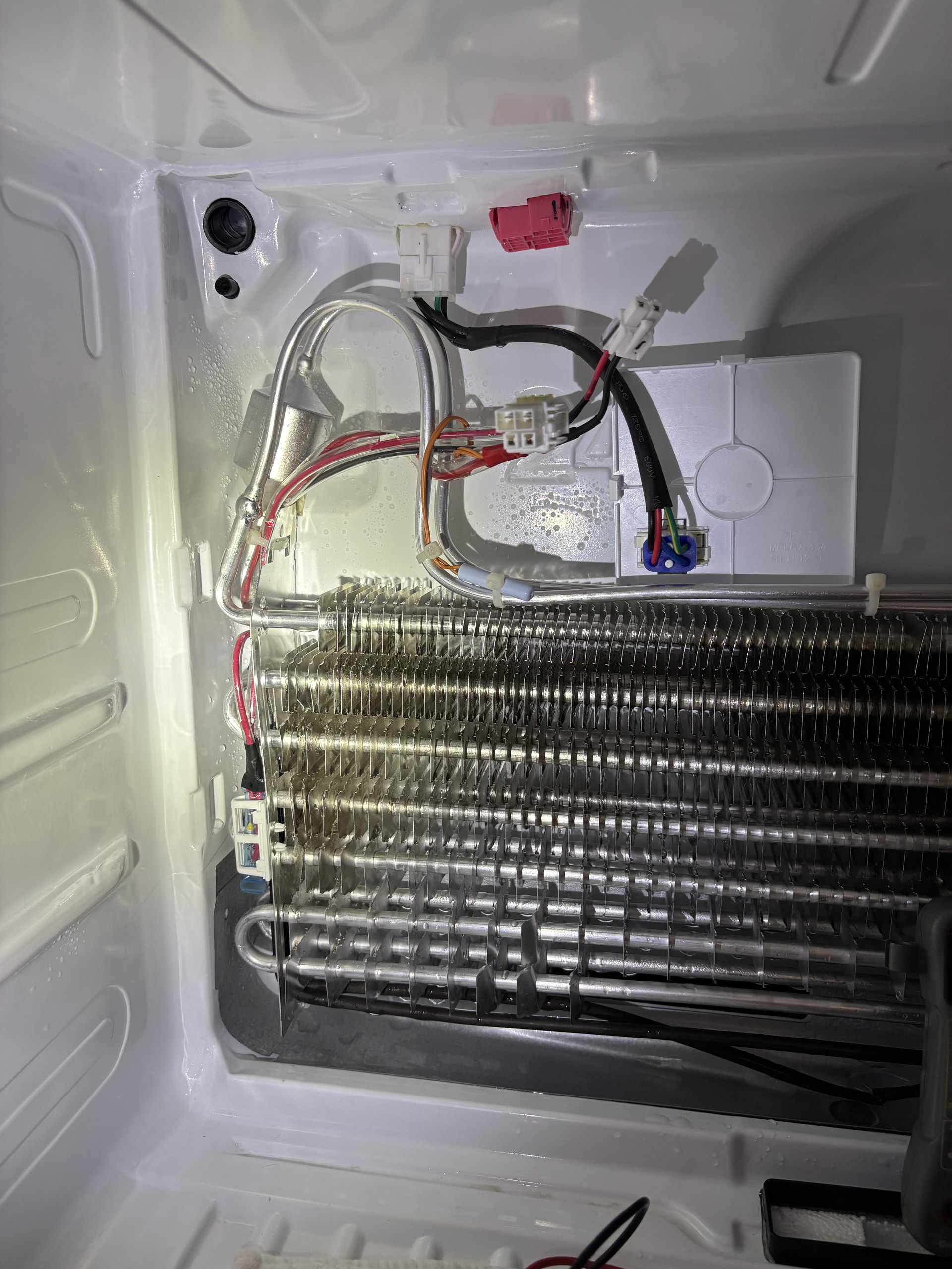

Jeffrey,
Thanks for your help. Going to try to check the evaporator coil after work. I will let you know
Evaporator coil right after dismantling. Ice in the bottom tray
Defrost heater ohm reading 75.4
Thermostat reading 0.2. Assuming the lower plug on the left is the thermostat
Water dripping from the freezer door left a puddle on the floor
Reassemble or leave unplugged.

Yes, the drain trough was filled with ice and the drain opening was covered. You might be able to see it in the 2nd picture from the bottom of this post.
Is my thermostat good? I had a reading of 0.2? Temp was around 55 degrees. That’s nowhere close to your chart I had the ohm meter on 200 ohms when I tested.
I will check on the drain tube.
pdl2
Drain tube is clear. Reassembled. Freezer at 30 degrees in a short time on setting of 3. All lights illuminated now on refrigerator temperature control Slowly adjusting refrigerator temperature
