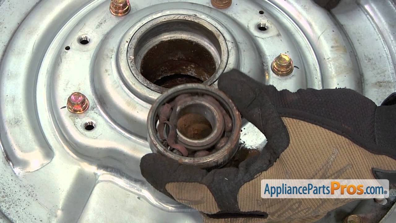

Set the tub on wood blocks, remove all perimeter bolts, and split it. Inspect the front half for wear; replace if gouged. Lift out the inner basket. Knock out the bearings from the rear half with a punch, clean the bores, and press in the new bearings. Run a thin film of liquid soap around the new seal and press it flush.
Re-install the inner basket carefully so the shaft doesn’t cut the new seal. Bolt the two tub halves together, then lift the tub back into the cabinet, hanging it on the springs first. Re-install shocks, hoses, harnesses, weights, stator, rotor, rear panel, and front panel in reverse order. Re-seat the door boot, spring clamp at 6 o’clock, and reconnect the control panel and detergent drawer.
