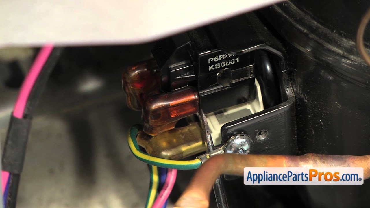

Now that we have the cover off, we can take the wires off the Compressor Start Relay.
There's two wires, a blue wire on this side and a pink wire on this side.
Sometimes they're on there pretty tight, so you can take a small flathead screwdriver
help pop them off.
Once you have both wires off, we have to get behind the relay with a flathead screwdriver
again and pop it off the mounting pins.
Once you have it off the pins, you can pull it out of the refrigerator.

Now we can put the new Compressor Start Relay onto the compressor.
Remember all we have to do is line up the two pins on the compressor and push it into
place.
Once you have the relay pushed all the way on, we can reconnect the wires.
Remember the pink wire was on the connection farthest away from us and the blue was closest.
All you have to do is push them on so you get a good connection.
