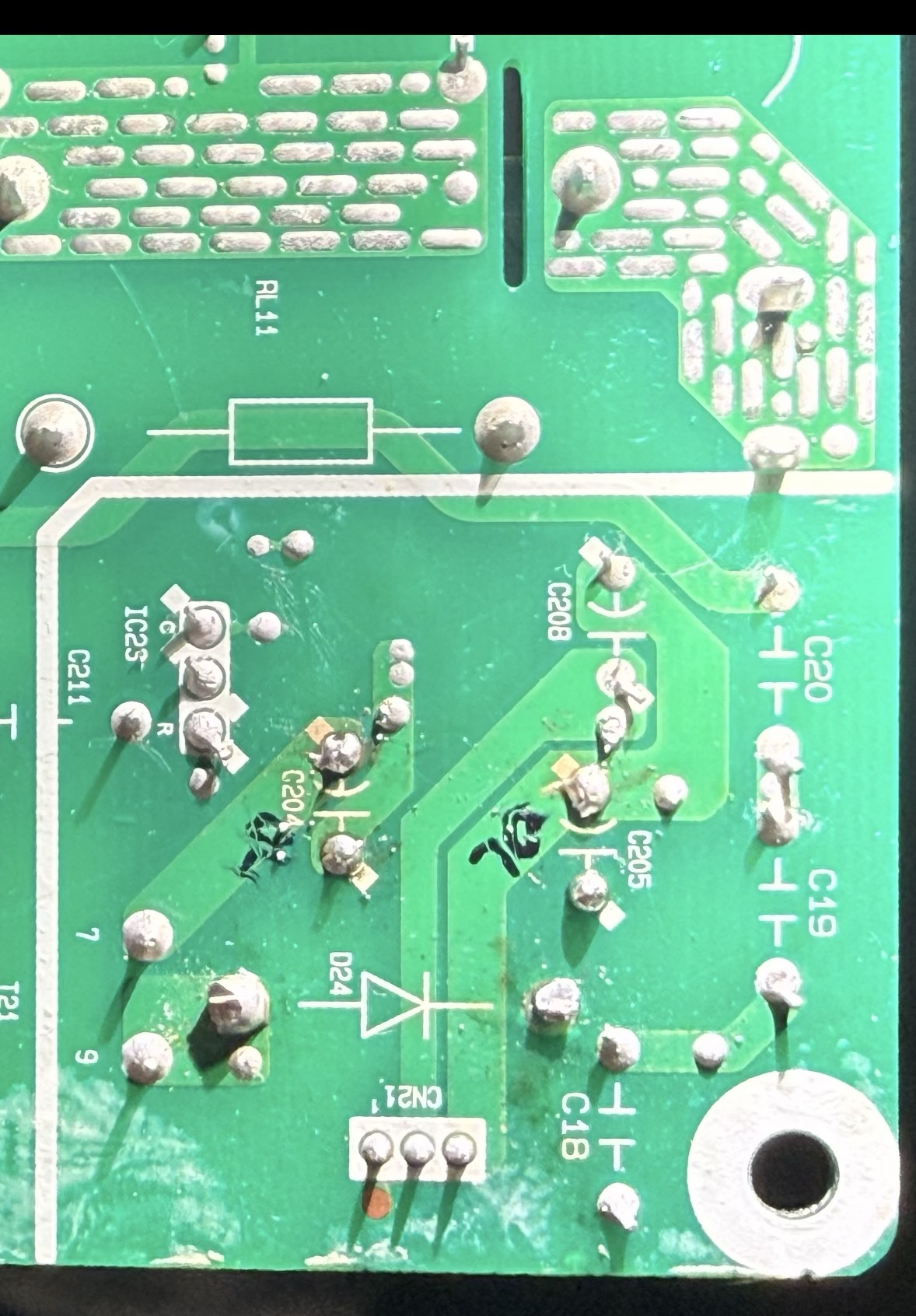

One week ago, using stovetop a loud pop and left side burners died. They make the ‘no pan on the stove’ song. Right side burners operate fine.
I ran the ThinQ diagnostics and it called out a failed inverter.
I called LG for more diagnostic info and all they gave me was to call a repair person. I’d would be happy to do that, but I live in Rural area and no LG service people will come. One person in town will do appliance repairs.
So DIY route chosen:
I ordered the left Side induction PCB and have taken the stove apart. I found a 20 amp fuse near the PCB that came off of the Noise Filter PCB.
I have not installed the new InverterPCB, but want to know path forward?

Running tests this morning. When left side burner is turned on left LED bar does 3 flashes (Communication Error) and error code CF7 (IH Left Comm. Error) (open/short).
I ordered a Noise PCB just to be safe. I buttoned up the range and it’s back in operation until the Noise PCB arrives when I’ll replace both parts at once.
Was there any indicators of damage on the inverter or wires at all? Aside from the loud pop, was there anything else that was abnormal? The fuse failing is a sure sign that there may be something happening to cause it to fail.
I looked the boards over and saw no scorching or burnt lines. The fuse popped hard enough that one of the caps came off and it flew out of the holder. Something went to pretty much a dead short. I have an inverter in hand and now a noise board on order. I figure replace maximally to prevent replacement parts from being fried.
If the front left and right, and the left rear and center rear elements have a 10 Ohms resistance reading across the coils (right rear should have a reading of 570 Ohms), and nothing is grounded out, then replacing both of those parts at the same time would be the safest bet. I agree that something had to have gone to a dead short to get the fuse to pop like that, and it definitely seems like the left side is going to be the main culprit.
So tore it all apart on Sunday, replaced the Inverter PCB, noise board PCB. My meter read zero ohms on both the left side coils. As the Left rear wasn’t in use when the failure happened I assumed it was something about a DC ohm test on a reactive AC load, so I continued.

The left and right inverter boards are different part numbers, but the “noise board” is the same for each side, and is known by EBR82008001 (or less commonly EAX66947101-H, mostly posting that as it’s centrally printed and not much comes up online except for one eBay listing).
Well, after spending 200 for an inverter and 100 for the unneeded oven board, I didn’t feel like spending another 50-200 for one of those, and since there were 2 identical boards with one known to be working, I started looking for differences (with the help of ChatGPT). I found the marked capacitors having very low resistance, pulled them off and they seemed to test okay and the pads still showed shorts, eventually I found D24 showing as a short, removed it and confirmed. I ordered a quick pack of SR5100 (5A 100V Schottky) from Amazon, and while they might not be perfect matches, putting that in and replacing the original caps, and the left burners are back in action. They appear to be working fine since!
So with the help of a bit of AI I was able to repair the board rather than replacing it!
