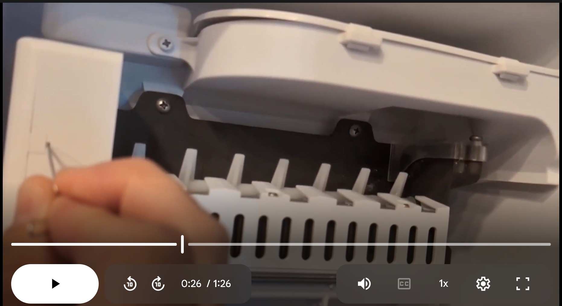

Main Symptom: Ice maker doesn’t harvest the ice.
What happens & when: It works only after I reset in Test Mode.
Error Code (if any): No error code
Parts or tests already tried: Yes, I tried to use the pin to reset the ice. I then closed the door and the ice cubes were pushed into the bucket, the water refilled the tray, ice were made but never get to push out (harvest) into the bucket (it only does so after the reset).
Brand: LG Elite
Model Number: 795.74093.410

Yes, it moves once only after I reset it. After that it never moves again even new ice cubes were formed after a few hours.
Would you happen to have a picture or, even better, a short video showing what the appliance is doing? That would help us see the symptoms and narrow down the issue.
Can you view the attached video link?
LG Ice Maker Issue
I’m sorry, I can’t view it. Could you post it in the thread,
How about this link: https://drive.google.com/file/d/1B4F-eFKVoYRSG9IwKTdXHNlhsKN0f7PF/view?usp=drive_link
Hope the video was clear of what you’re looking for. Please suggest any malfuction and parts that can be repaired. Thanks!
The video keeps saying it’s unavailable. But basically, it makes ice normally, and when you press the button to dispense the ice, it doesn’t push the ice out, correct?
I clicked on the video link, and it worked every time. You can copy the link and view it on your PC/phone. Anyway, it pushed the ice out only after I reset the icemaker by using the pin (photos). After that the water refilled, ice was made, but it never pushed out by itself.
The fact that your ice maker cycles and fills with water when you press the manual test button tells us that the motor, heater, and water valve are working. The problem is that the ice maker is not triggering the harvest cycle automatically.

The ice maker has a temperature sensor that monitors the temperature of the ice mold. The control will not automatically harvest the ice until the mold gets cold enough. If that sensor is failing and incorrectly telling the control that the mold is still too warm, the ice can be completely frozen but just sit there until you manually run the test.
Since the thermistor is generally part of the ice maker assembly, if the sensor is bad, you would normally replace the complete ice maker assembly.

The ice maker relies on an internal temperature sensor (thermistor) attached to the bottom of the ice tray
you will need the part number from the your old ice maker to replace it with the new one.
