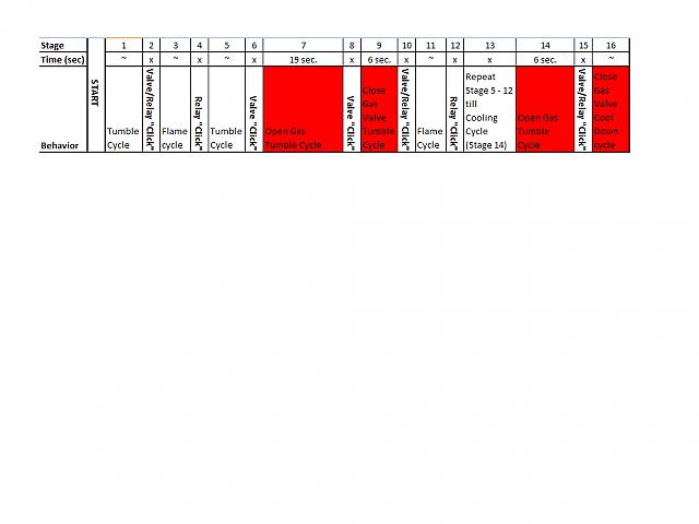

I don’t have much choice but to ask (had 6 service men come) they keep replacing parts, and haven’t been much help.. instead I mapped out the heat, tumble cycles and noticed that the gas valves open (with no fire up) for an exact duration of time during the heating/tumbling cycles… I already had the entire gas assembly replaced, flame sensor and ignitor replaced… I think it’s a controller issue but not a single repair tech will listen to me… does this seem like a controller issue?
image attached
Yes, I think it is a jproblem in your controller system, and it could bde either the control electornics or the wiring, but the thing that really concerns me is your dryer is not supposed to do this. These dryers have a built in “flame detect” systems that are supposed to shut down the gas jets and not allow gas into the environment if no ignition is present.

I have had the exact same problem with my LG gas dryer. I was fortunate enough to be near a LG authorized service company. The technician rather quickly diagnosed this problem and changed the main control board. Problem fixed. The dryer did this right from the start, but it took me too long to make the call. The labor and parts was still done under warranty. I would say that this should have been a recall by LG but I have been unable to get them to fess up.

Anyway, to ‘eliminate’ the possibility of the gas valve being the problem, the tech swapped it out with a known-good one. Problem still persisted. So he ended up deferring to it being the control board and placed the order upon me putting down a $100 deposit. Apparently, the entire thing will cost me around $350. Thanks LG, for making me fix what should be considered a major safety recall on my own dime!

I was having similar symptoms and have finally solved my issue.
We noticed that clothes weren’t drying as well as they use to…when using sensor dry they would come out slightly damp (just barely). Intermittently we would smell natural gas in the laundry room. After reading numerous forum posts, I decided to swap out the main control board because many people said changing the ignitor and gas valve didn’t fix the problem. I thought that I had fixed the problem as we didn’t smell gas for a few weeks.
Well, the problem did come back a few weeks later. I ordered a gas valve thinking that was the most likely culprit. The swap out that part I had to remove the drum which exposed everything in the dryer nicely. It turns out the exhaust tube had dislodged internally and a decent amount of lint was being blown inside the machine. Lint was everywhere.
The lint had built up inside the gas tube and must have caused turbulence in the gas flow which prevented it from lighting properly. I cleaned everything up, reconnected the exhaust tubing and taped it securely before putting everything back together. I didn’t replace the gas valve as the original one ohmed out properly. The dryer has been working like new for several weeks now.
I hope this helps other with similar problems.
