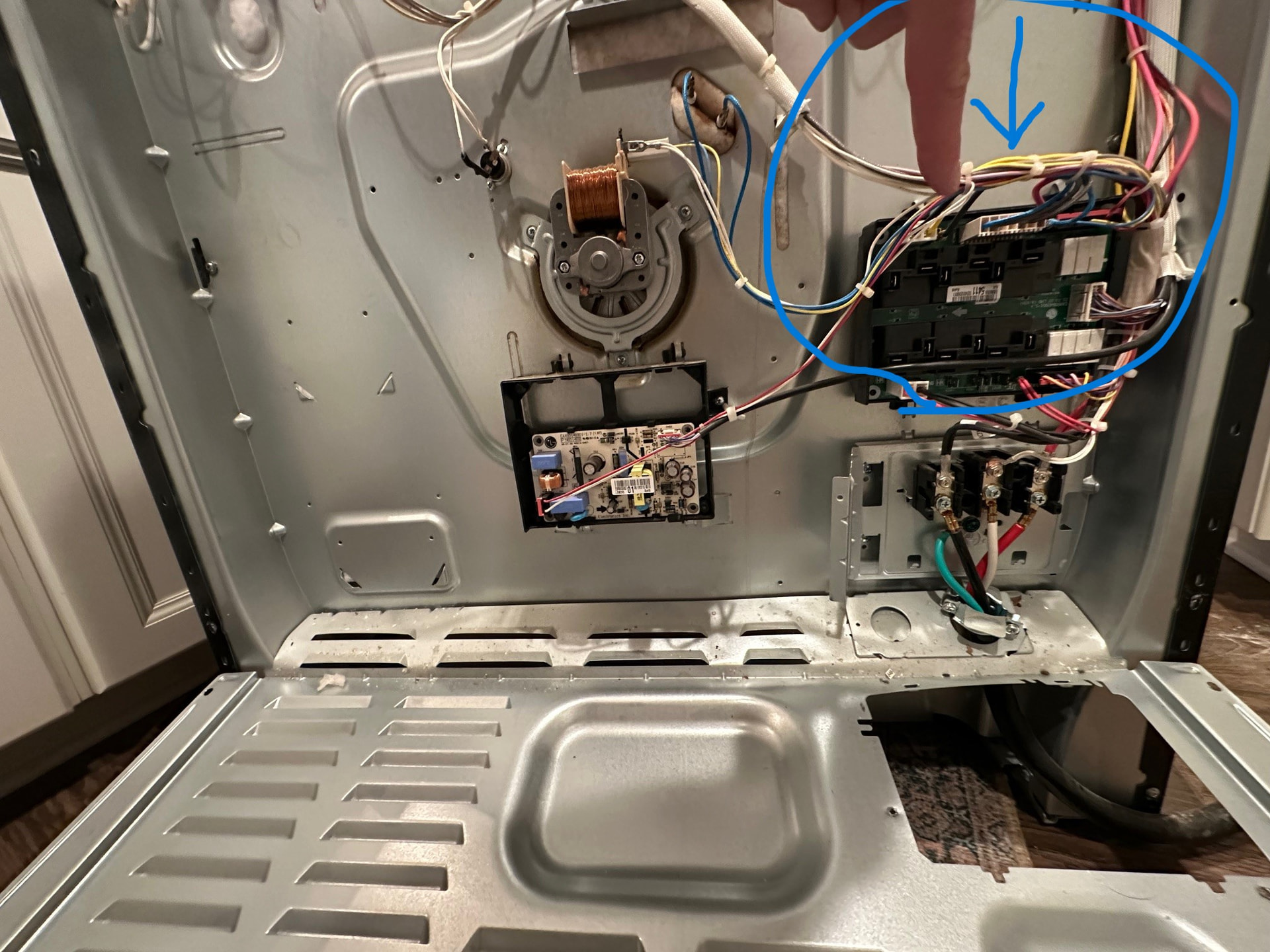

Thank you very much for your help. Is this the board in the control panel or on the back of the range?
This would be the one on the back of the range.

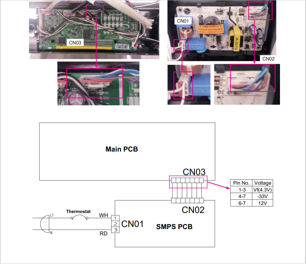

The water can create an electrical short that can damage electronics, such as a control board. The burner on light coming on indicates the relay control is allowing voltage to flow through to the oven main control, and that the oven main control is allowing the surface burner on light to turn on. If you access the power board behind the range, voltage testing can be done to identify what might be stopping the main control from completing its proper function. Here is what the DC voltages should be at each pin on the 7-wire connector. The pins are the same as what they would be on the main control. Let me know what readings come up.

For reference, the part suggested was not the Main PCB but the control board circled in blue
Correct, the relay control circled in blue was suggested.

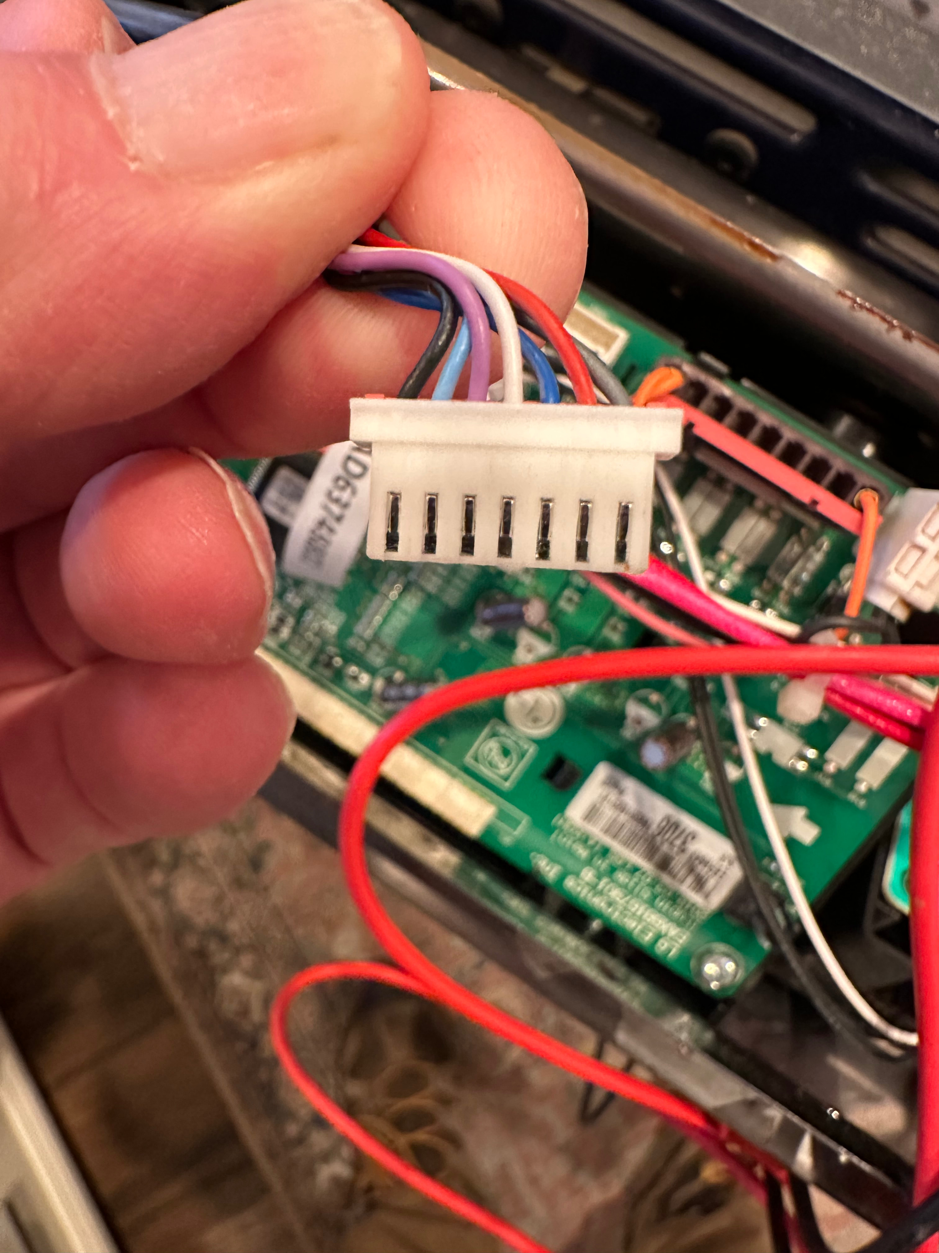

I want to make sure I am reading the proper connector. White arrow pointing to what I believe is the connector with a close up of the connector
The first image is the correct connector from what I am able to identify. When testing, it will need to be plugged into the control. If the meter probes are not small enough to fit in, a piece of small wire or a short section of a thin paper clip can be used to act as an extender by taping it firmly against the meter probes.
Please forgive the constant questions. When you say 1-3 I should be touching pins 1 and 3 to get the reading of (4.3)
You are correct. After testing from pin 1 to pin 3, pin 4 to pin 7 then pin 6 to pin 7 would be tested.

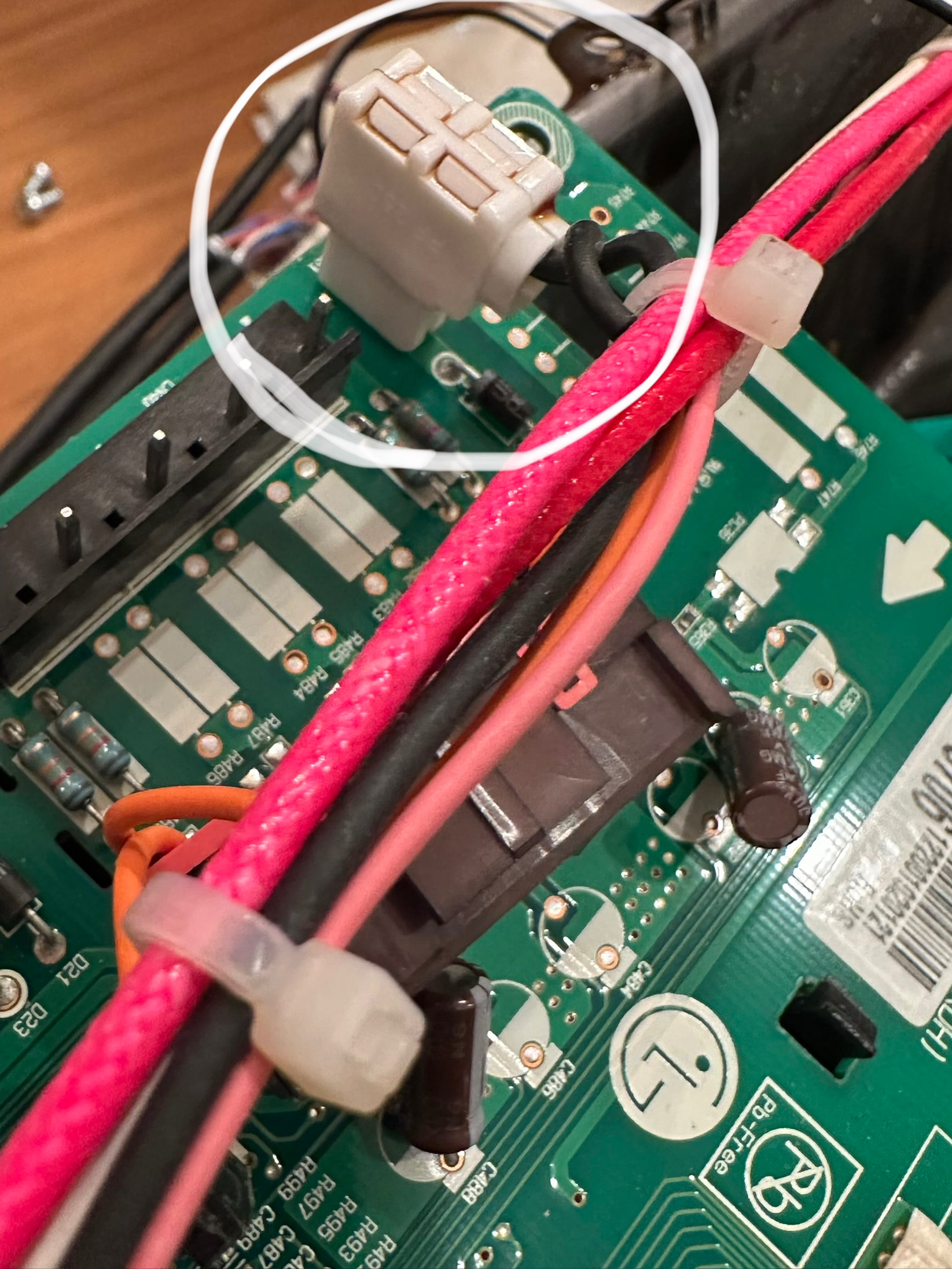

How does this connector come off? I have tried everything I can see. It is the last connector on the bottom left hand of the board
