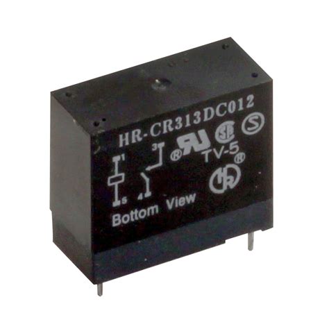

Don’t know much about LGs, but I would say it’s a stuck relay. You could try carefully tapping on each relay to see if that breaks the contacts apart. Use something non-conductive like a screwdriver handle.
If it is the relay, you could replace the board or just the relay. The latter requires some soldering skills.

Thanks for the response. Only problem is I don’t know which component is the relay. I’ve taken it apart and tapped on several larger black caps but it didn’t resolve it. How would I go about identifying the correct component to tap?

Well in the process of doing laundry today the dryer has resolved itself. Its functioning properly.
What is the likelihood of the issue returning assuming it was a stuck relay? Will it just get stuck again?
The reason they stick is because the electrical contacts inside them, get stuck together. And yes it will probably happen again. This is a relay…
and this too…
Also there are larger high amperage relays on your board. These have two fairly large wires to the back of them. Usually these are for the heating element.

Thanks for the additional info. I’m sure I will be back fixing this at some point in the future.
