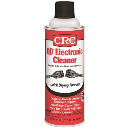

Sounds as if when it gets hot things work ok. Then perhaps some of your machine wire connections to or from the control board may be damp/corroded. Fortunately it does work when heated so the control board likely is good. I have read some forums suggesting to use a hair dryer to rid the connections of moisture aiding in contact. I however think if you disconnect the wire terminals and clean them with a wire contact cleaner this would be better and more permanent. Here is a pic of one kind of contact cleaner.
electric cleaner.jpeg (20.6 KB)
thanks for the suggestion. I will definitely try it.

Ok I see a little better now. So when it gets hot the system isn’t working properly. I still am leaning towards the connections being an issue. Not starting or staying started is a symptom of the control board and if the control board has faulty or corroded connections it may be your cause. Try disconnecting the wire connectors to and from the control boards and user interface and clean them as described above.
