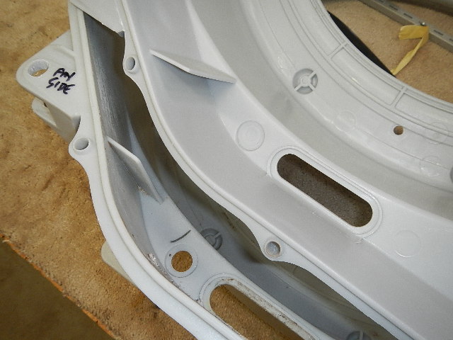

Ok, need some advice. First, you said you could email me some diagrams which I would appreciate. Can you get my email address from my order# 3307917? Don’t want to post it here.

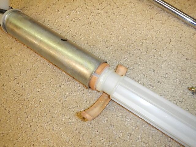

Here are questions related to attached photos…
Dampener: In taking off the front tub housing, I pulled the dampeners apart. They look fine, and slide back together easily.
[LIST=1]
  • Are the rubber rings supposed to be split? If yes, do they need to be put on 180 degrees offset to get better seal?
  • Do they need to be lubricated, if so with what?

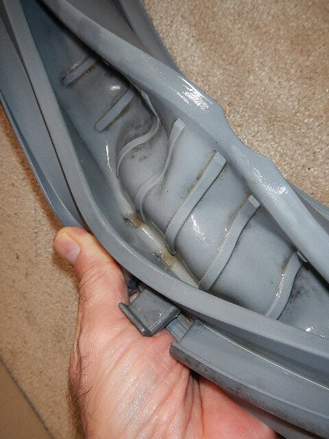

  • Should they be pretty stiff when manually testing them?[/LIST]Which Hole: The newer design tub seal has three areas marked for cutout, but none are.
    [LIST=1]
  • I’m guessing I use the one with the “X”?
  • Any special method to cut the hole without otherwise damaging the seal?[/LIST]Thermister hole missing: The new front tub cover does not have a hole for the thermistor.
    [LIST=1]

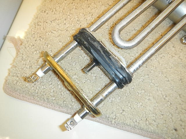

  • Any specs on it or measure from old and drill it out? I want to avoid leaks![/LIST]Heater Gasket: It looks like it either had some type of sealer on it or it’s just gunk. Any special instructions on re-installing, again to assure no leaks?
