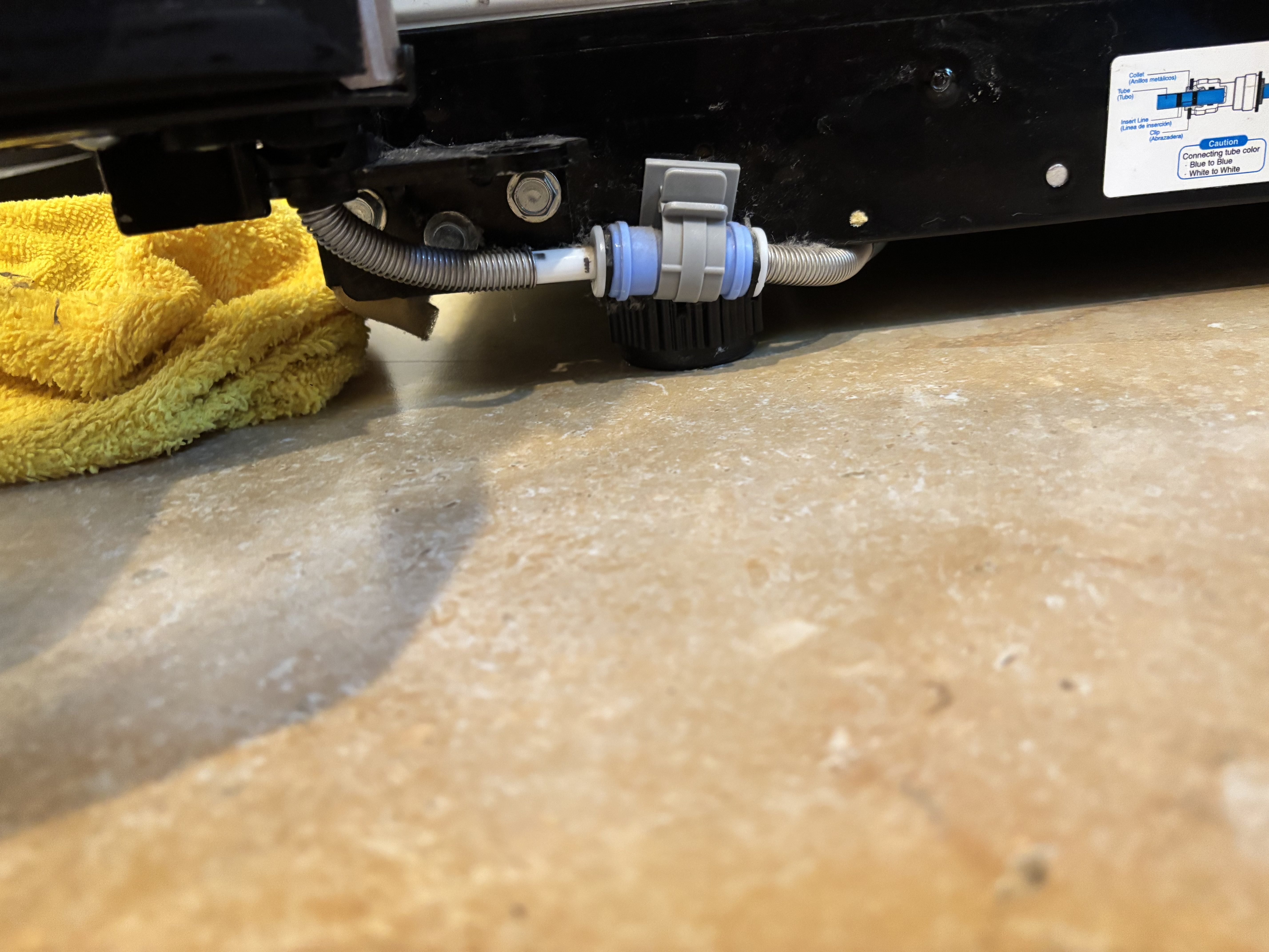

Leaking water dispenser line
Brand: LG
Model Number: LSC279ST
Main Symptom: Water supply line to in door water dispenser broken
What happens & when: water line broke where it transitions to vertical, past the coupler and spring at the bottom of the door. Can it be repaired? It appears there is no way to access the line inside the door that goes to the dispenser.

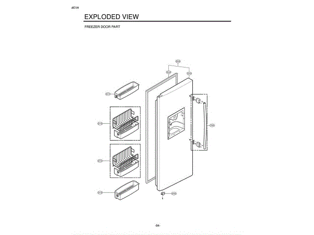

It looks like the water tube is foamed into the door, according to the manufacturer’s information. In this case, that means the tubing cannot be replaced on its own—the entire door would need to be replaced.
Unfortunately, the freezer door has been discontinued by the manufacturer. You can see that noted at the following link:
