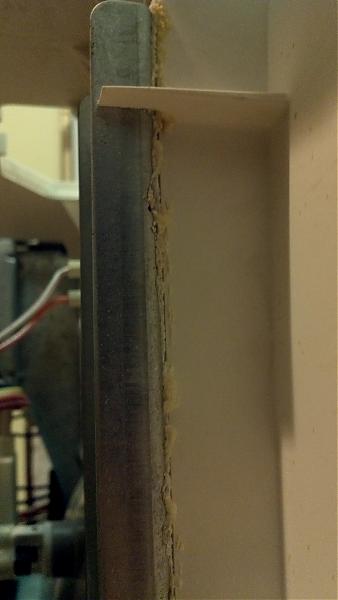

I’ve noticed a leak coming from bottom of dishwasher.
I pulled it out and ran it, it seems to be coming from the rear bottom of the tub.
You can see from the images I posted, you can certainty see where the gap is where the water has cleared out the sealant between the tub and a metal bar attached to the tub. Theres one image of the whole thing, one of the right side that is good and one of the left side that seems to be bad.
To me it looks like I have 3 options.
  1. Unscrew the bar, apply some type of sealant and reattach.
  2. Get a whole new tub.
  3. New dishwasher.
Looking for any info on option 1. Type of sealant, is it possible, etc..
Thanks.
It is hard to tell exactly where the leak is coming from.
I do not think that it is leaking from under the bar.
The crud you see looks more like calcium deposits from a slow leak. The water evaporates and leaves the mineral deposits.
It is more likely that it is leaking from the pump seal and then rinning under the bar and collecting there.
You will not know for sure until you remove the bar and check under neath it.

After digging into this a bit further, I’ve discovered this.
It is leaking under the bracket, but it’s because there is a hole in the bottom of the tub. I found this recall pdf from whirlpool. After direction #28, there’s a picture of the bottom of a dishwasher with a hole they tell the serviceman to look for. That is exactly where my hole is and the reason for the leak.

So, is that repairable? They reference a loctite n27 steel quickset, but I don’t think that product exists under that name anymore.
Any suggestions?
[COLOR=“Blue”]So, is that repairable?[/COLOR]
Yes it should be.
If you have the old style heater call Whirlpool and see if they will replace it or do something for you.
If it is just a small hole as shown in the recall.
Hopefully the bar will come off fairly easily.
Remove the metal bar and clean off the mineral deposits.
You will probably be able to scrape them off, try not to scratch the tub especially where the hole is. If they are stubborn , wet a folded over piece of paper towel with vinegar and then place this on the deposits and leave it for 15 minutes or so. This should dissolve/loosen the deposits.
Then get a small screw and screw it into the hole not quite all the way down.
You may have to drill the hole out slightly, just make sure that the threads grip OK.
Also use a stainless screw. Regular screws will corrode quickly due to the corrosive action of the soap.
Remove the screw and if it has created a ridge around the hole inside the tub cut or carefully sand this off.
Then put some silicone/sealant over the hole and screw the screw all the way down. Do not over tighten it as you do not want to strip out your screw hole.
I would use high temp silicone that they use for car engine gaskets etc. This should be able to resist the heat and the corrosive dishwasher soap.
It would also be a good idea to put some sealant onto the underside of the screw so it seals on both sides of the tub. This should also prevent the screw from backing out.
If the screw is too long. Thread it in to get the tub plastic threaded and then when you remove it cut some of it’s end off with a dremel.
If you have the room underneath for the nut, a bolt & nut will also do the job and will give a better seal on the underside of the tub.Use a dab of sealant on both sides of the tub.
Leave the kick plate off for a week or so, so you can be sure that your fix worked.
