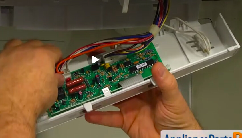

Hi, just double checking parts. The instruction video shows disconnecting the thermistor from the housing where the control board is mounted. But I don’t see it on the control board.
Is the thermistor integrated into board? On the close-up, I don’t see anything that looks like it senses air temperature.
Would like to try thermistor first if possible.
Whirlpool parts says this fits my fridge MBF1958DEE00. Does that seem wrong?
W10316760
https://www.whirlpoolparts.com/PartDetail/Thermistor/W10316760/1876627
Including snip showing control board separate from thermistor on right near air vent.
Final note: I was able to see that the thermistor is integrated into the harness. However, since it already passed the diagnostic test, the only other suspect is as you say the control board, which I’ll replace.
