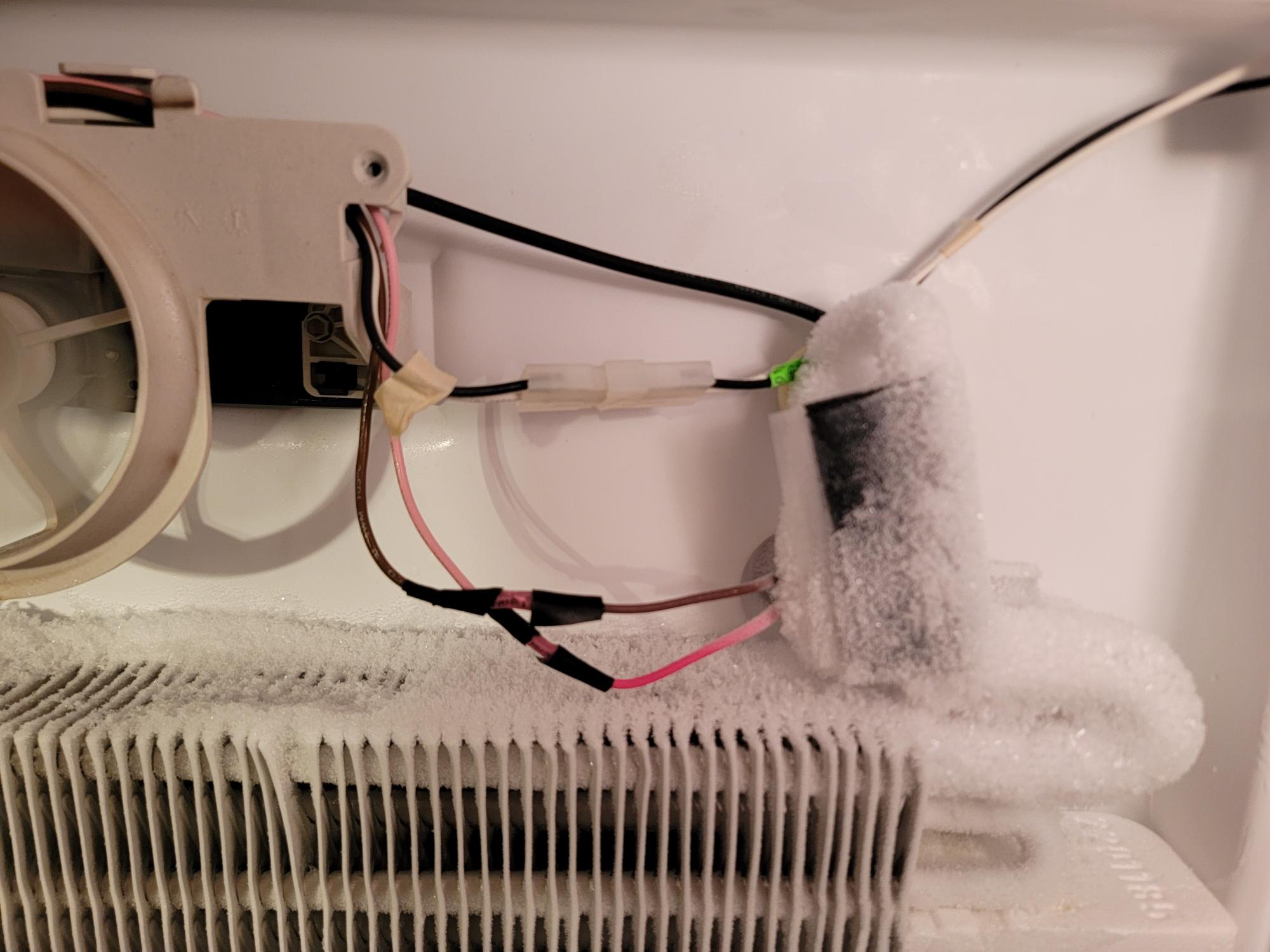

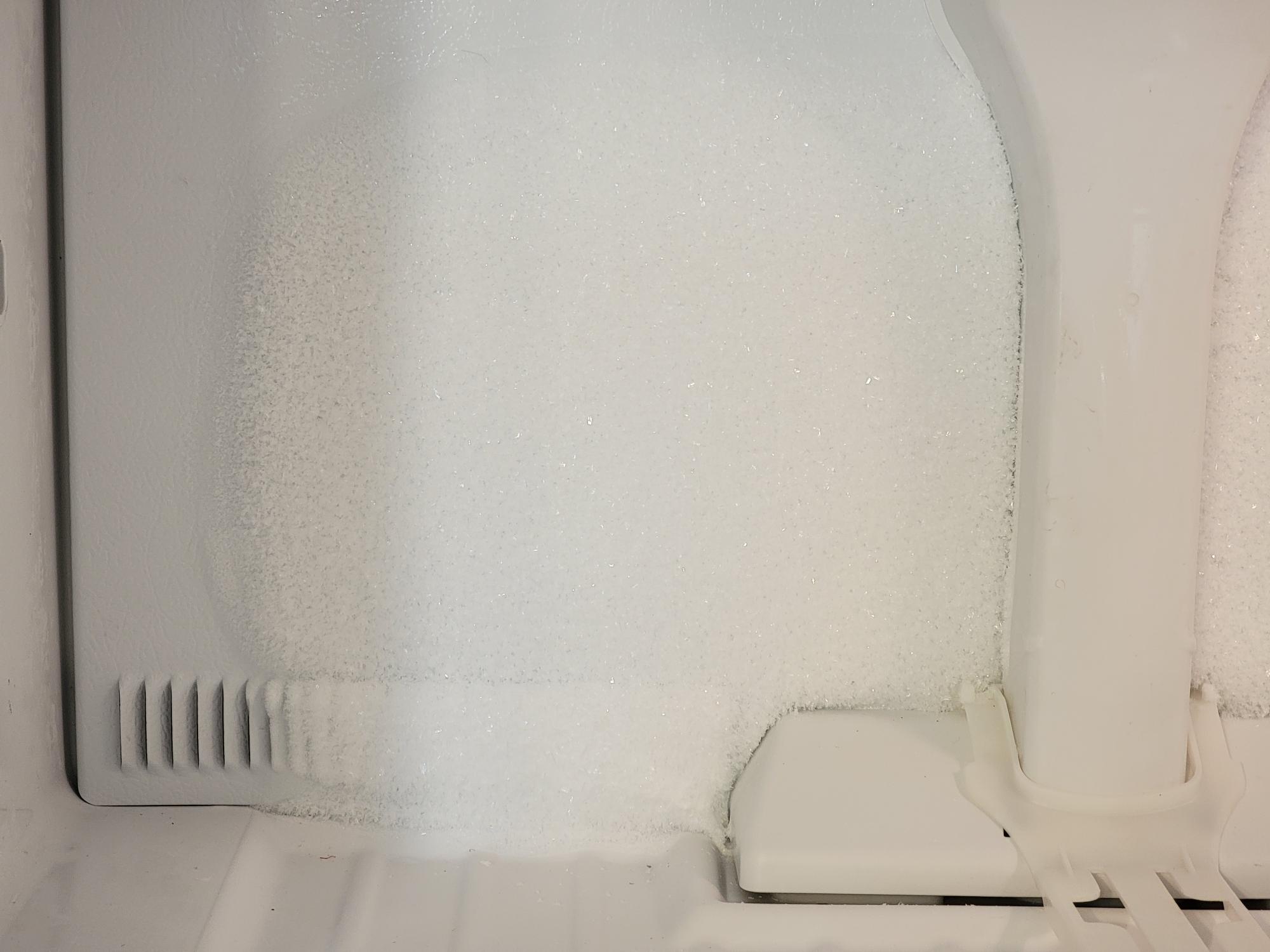

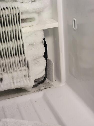

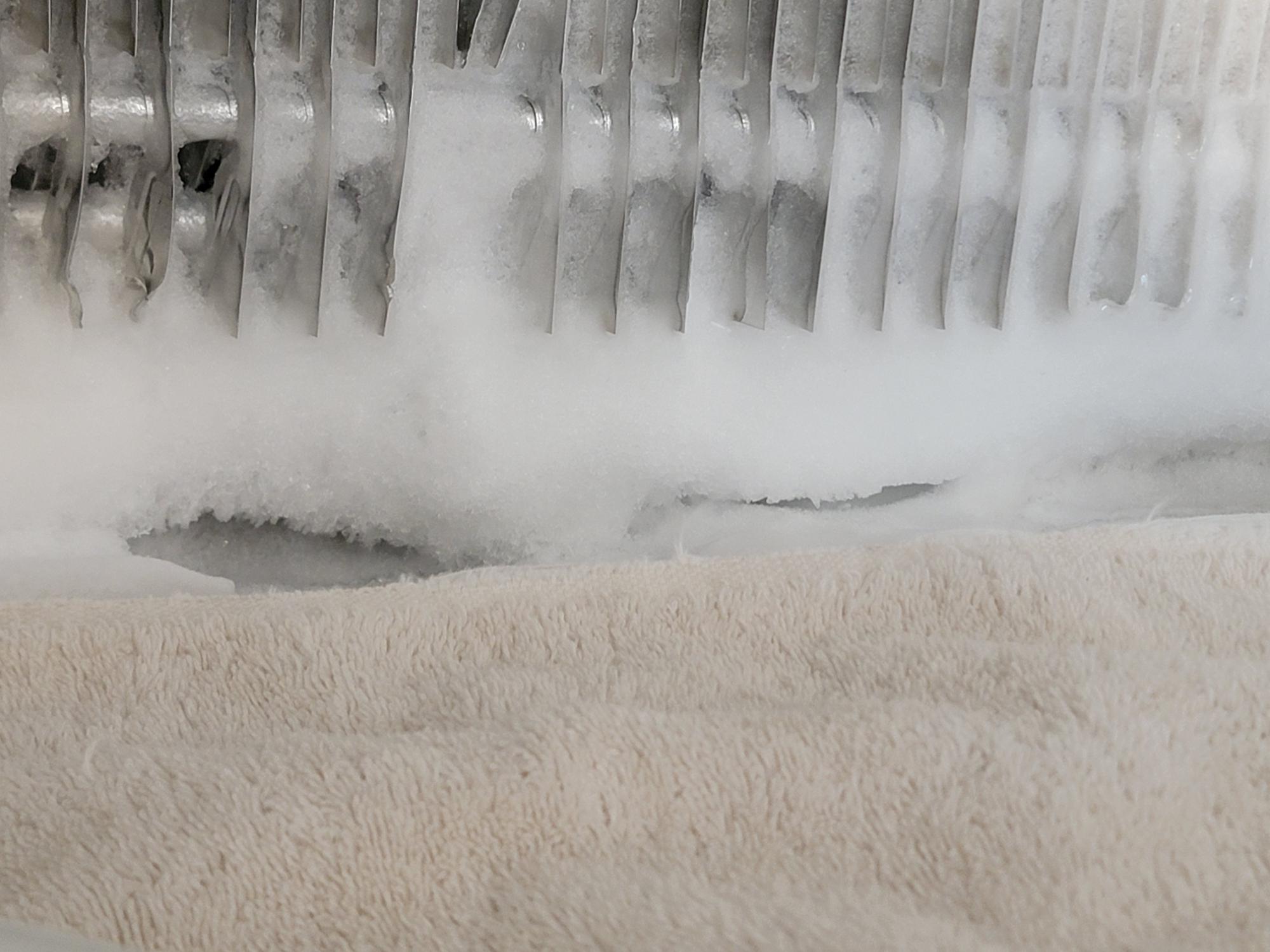

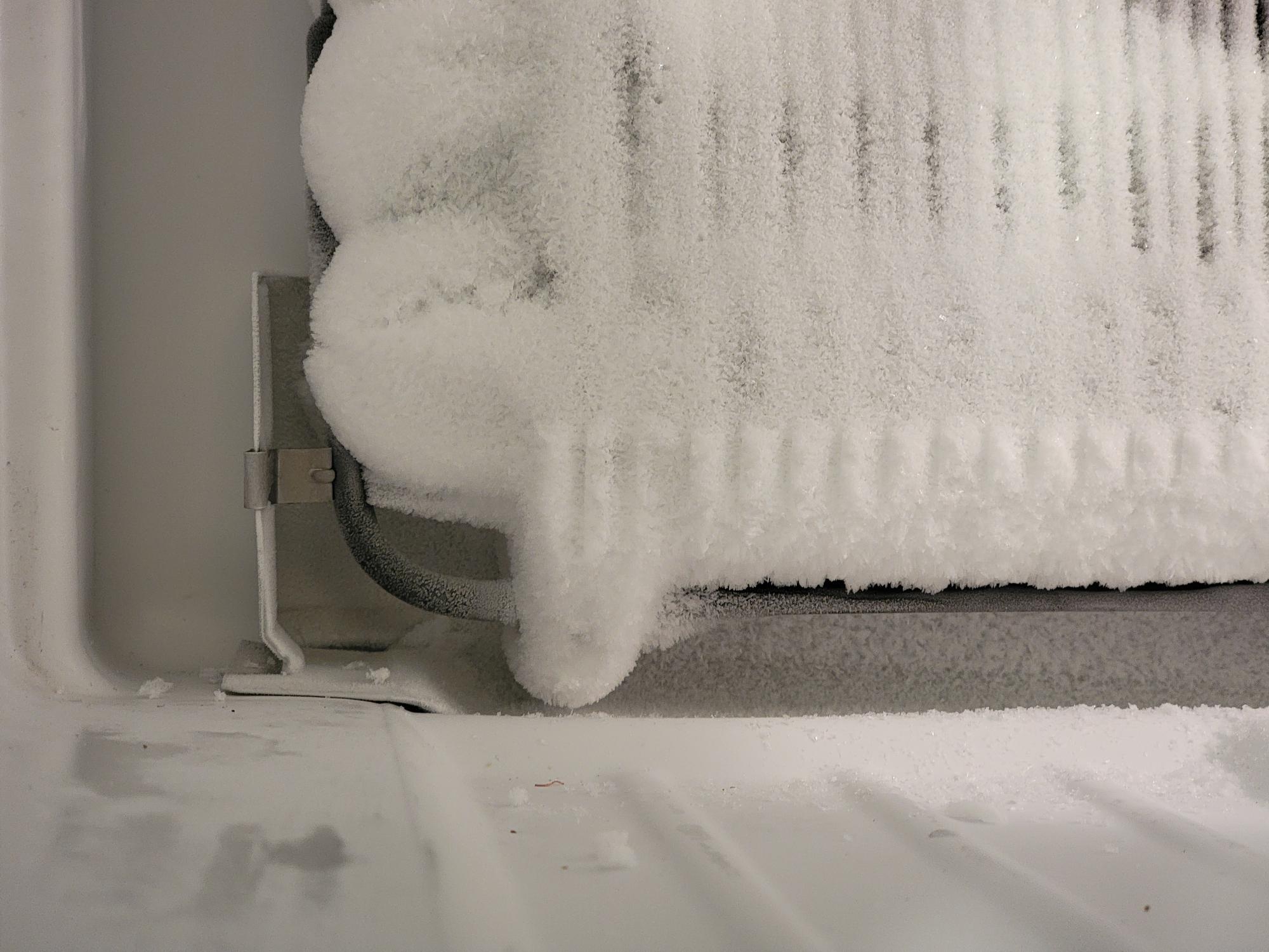

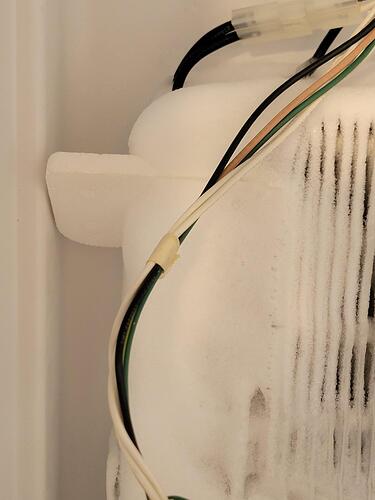

Hi Jose,
Pictures are after about a week of refrosting.
I see that the black heat element is actually not encased but the fins are still encased. I measured its resistenc with some difficulty before at 30 ohms but I still wonder if its not heating enough or being triggered.
The bimetal i replaced.
The fan seems to be working well.
I don’t know what to do with the thing in black foam. If its a thermost i’m not sure how to test it.

Hi Kevin,
It looks like the thermostat is the component on the right side of the fan, where the black tape is located.
Based on the symptoms, the most likely causes are the defrost timer, defrost heater, or defrost thermostat.
Faulty defrost timer: The defrost timer controls when the freezer switches between cooling mode and defrost mode. Under normal operation, it cycles throughout the day to prevent frost from building up on the evaporator coils. If the timer fails, the defrost cycle may not activate, allowing frost to accumulate.
Faulty defrost heater: If the defrost heater is not working properly, it won’t melt the frost from the evaporator coils during the defrost cycle, causing ice buildup.
Faulty defrost thermostat: The defrost thermostat monitors the temperature of the evaporator coils and signals the heater when to turn on and off. If the thermostat is defective, it may prevent the heater from turning on, which can also lead to excessive frost buildup.
The door seal could also be contributing to the problem. I know you mentioned it’s been that way for a while, but over time even a small gap can allow warm, moist air to enter the freezer. Eventually, that extra moisture can cause significant frost accumulation.
To test the defrost thermostat, remove it from the appliance and use a multimeter set to continuity or ohms. Since it’s temperature-activated, test it both at room temperature and at freezing temperatures to verify that it opens and closes properly.
Here’s a video that may help guide you through the testing process:
https://youtu.be/bxP-o3-rnoE?si=N9CzHDLNRc_Vm2RH
