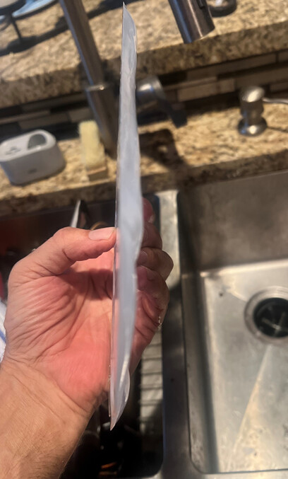

Kitchenaid under counter ice maker Thin ice sheet
Brand: Kitchenaid
Model Number: KUIC15PRXS1
Main Symptom: Thin Ice
What happens & when: The Ice sheet is thin when it is released to the cutting grid. I would expect a 1/4" to 1/2" thickness however ours is only about 1/8". Would this require a new Temperature sensor (PN: WPW10548509) this part is no longer avail. can you suggest a similar to PN that can be purchased? Could this be the evaporator plate is showing signs of early failure ( PN WPW10218037)?
Parts or tests already tried: I’ve gone into program mode #10 and selected 6 flashes to indicate Thickest ice sheet production The water fill into the reservoir is rapid (loud and fast flow), the Fill level int the reservoir is almost to the top of the Temp sensor. Machine is producing ice, when it drop after cutting is only chip size.
The issue described could very well be the temperature sensor, the wiring to and from the sensor and/or loose connections. I do also show that the sensor has been discontinued by the manufacturer and does not show an alternate replacement part.
