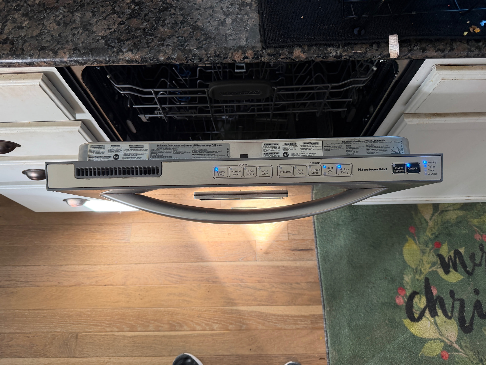

KitchenAid touch panel lights stuck on - do I try replacing board or just buy a new dishwasher?
Brand: KitchenAid
Model Number: kuds40fvss3
Main Symptom: Several lights on on the control panel, but buttons unresponsive and won’t run; seems stuck on “Washing Cycle” on the panel, but won’t run
What happens & when: Reloaded dishwasher after it had finished, then noticed the 5 lights stuck on on control panel. Buttons are unresponsive (see photo…current lights are “Heavy Duty”, “Heat Dry”, “4 Hour Delay”, “Cancel”, and status light says “Washing”). Dishwasher won’t start.
Error Code (if any): None
  1. Tried switching off the breaker, waiting 10 minutes, and turning back on. No change.
  2. Tried removing the ribbon from the control panel, then closing door, then turning breaker back on, no change (some said maybe it will start to drain automatically, then I’d know it was the touch panel, not the control board).
  3. Tried holding the “Heat Dry” to unlock, that did nothing.
  4. Tried pushing various combinations of buttons.
The big question is do I try to buy a new control board and install it, but I can’t return it and that’s $200 (they don’t make the touch pad so I cannot try that), or do I just buy a new dishwasher.
I think the control board is Wpw10285179
Hello, I agree that it looks like a control panel problem, and the parts are NLA. You might try finding a part on EBay.
Hi, thanks. So you think it’s the touch panel, not the control (circuit) board, correct? Just wanted to make sure I was understanding right. Thanks!
You know the board is sending power to the interface/panel because it lights up. The panel will not change settings when you press certain buttons, that is the panel, I believe you have a shorted keypad/panel.
