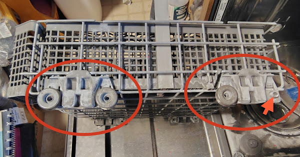

Kitchenaid KUDE60FXSS1 not matching exploded diagra
Brand: Kitchenaid
Model Number: KUDE60FXSS1
Main Symptom: Parts do not seem to match online schematics
What happens & when: N/A
Error Code (if any):N/A
Parts or tests already tried:N//A
Photos / video link: This is the actual upper rack for the KITCHENAID KUDE60FXSS1 it has “wheels” and ı do not see anything resembling the correct part in the exploded schematic and I have double checked and I am entering the correct part number.
Google Photos
Google Photos
The schematic the Appliance Parts Pros database gives me does not seem to visually match. I am not sure where the issue is. Am I missing something or is there a mismatch with the diagrams and the part number: KUDE60FXSS1?

Any clarity on this would be appreciated. Did not think this was going to be a big deal,-but now I am wondering. Thanks.
You should be able to use this video.https://www.youtube.com/watch?v=7NwddXyQ0-g
parts-list-W10391474-RevA.pdf (4.3 MB)
Based on the pictures provided, it looks as though the rack in question would be the lower rack as the silverware basket is attached. If this is the case, the lower rack wheels would only be available as an assembly where the wheels and the mounting base are together as a whole as seen in the following link. Reference diagram link is also attached.
Wheel assembly- Whirlpool W10195416V Dishwasher Lower Rack Wheel Assembly | Genuine OEM Part
Diagram reference- Parts for Kitchenaid KUDE60FXSS1: 10 - Lower Rack Parts - AppliancePartsPros.com
