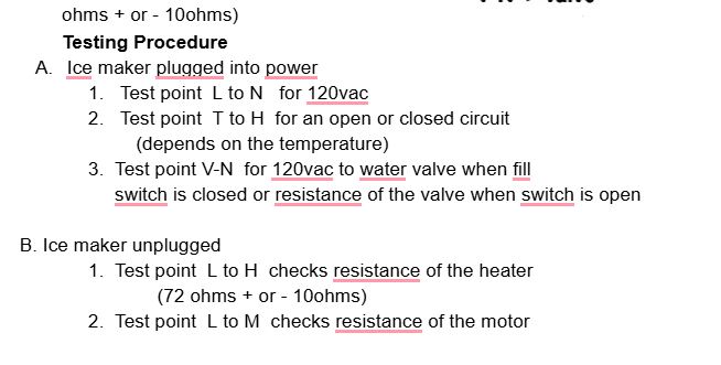

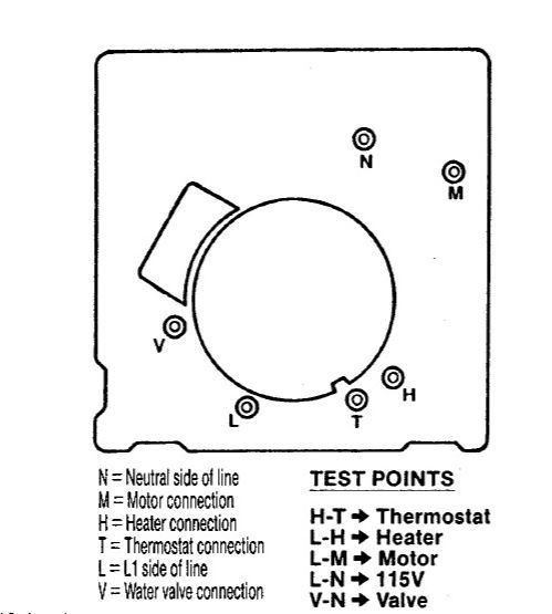

Thanks for the diagram, here is what was measured.
Ice maker plugged in
  1. Point L to N - no voltage - made sure door switch was closed but still no voltage
  2. Point T to H - had continuity when cold
  3. Point V to N resistance of 181 ohm when open, could not test fill valve when fill switch closed
Ice Maker Unplugged
  1. Point L to H - 49 ohms
  2. point L to M - 66 ohms - this bounced around with auto ranging multimeter but not manual range one. I cut power to the unit but still plugged in.
I also re-verified and decreased temp in Freezer. Freezer had been between -4 and -1 and the ice bin between 1 and 5 degrees. Any thoughts on what the issue might be?
