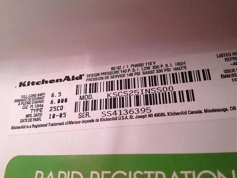

Hello,
My KitchenAid (photo of info label attached) ice-maker works intermittently (maybe two cycles/day).
[LIST]
  • After ice-eject, tray fills with water, water freezes, but doesn’t eject for several hours. I get about three cycles per 24hrs.
  • When flapper is closed, light blinks twice between one-second pauses.
  • I removed & thawed ice-maker module overnight; no change.
  • When in doubt, wiggle stuff! Oddly,giggling the ice-making module seems to induce an eject-cycle.[/LIST]I’m a retired electrical engineer so I’m capable of make any diagnostic voltage measurements.
Thanks in advance. You guys helped me fix my electric stove for about $75 when two local yokels quoted me $700.
Joe
Hi.
According the info you provided it’s a bad optic ice level control.
When you close the flapper door the light should be steady on.
The optic control kit AP5956767
Here are the breakdown diagrams and Replacement parts for Whirlpool KSCS25INSS00 REFRIGERATOR | AppliancePartsPros.com
Thank you.
Simon.
