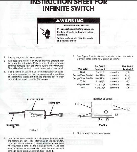

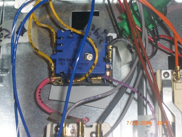

I have an old infinite switch that doesn’t match exactly with the new infinite switch. Pix attached.
I figured out the pink wire (power), the black and violet I already connected, but there are 3 orange that I can’t figure out where they go.

Also, the top picture was the old one and I think the pink and orange one on the left were in the wrong place.
Chris
did you take note of the wires and where they were located before you removed them?
No - (and I even sat there and thought about taking a picture before I pulled wires) but the 2nd picture (original switch) was my best guess, unfortunately when I tried to turn it on, the breaker blew. So the 2nd picture is incorrect, I am pretty sure the black, violet, and 2 orange black wires were correct. I might have switched the pink and orange/white.

So far I can tell you that the terminals L1 & L2 are for incoming power, the terminals H1a & H1b are for two coils on the dual heat element and the terminal H2 is for a common terminal on the dual heat element, and the P terminal is for the indicator light.

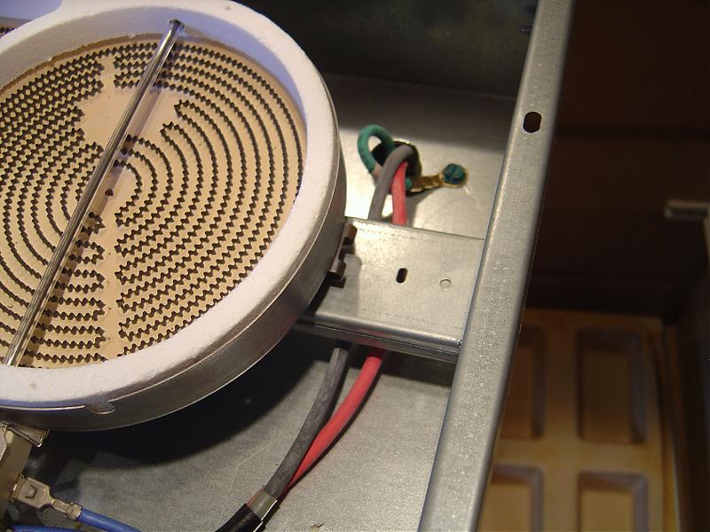

What burner this switch is for and what kind of the heat element it has?

If you can take pictures of this heating element, shown all terminals with wires and post them, it might help. Also try to read all white and black letters on the wires and post it too.

I found the wiring diagram for the stove and the installation instructions for this switch.

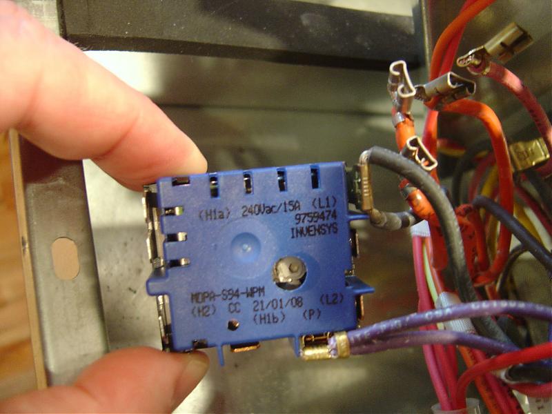

Here are some pictures of before/after of the infinite switch for Kitchenaid kitchenaid KECC560BBL2 stovetop. I hope this helps you.
If you need more pics, let me know…:slight_smile:
