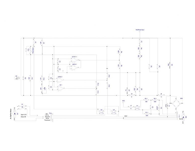

I’ve created an approximation of the schematic for the the control board that you can see in the attached JPEG. The intention is pretty straightforward. There’s an AC->DC power circuit on the right. On the left, two resisitor divider elements: one with the thermistor, the other with the refrigerator temperator setting, and a four element comparator that drives three SCRs. Two open and close the air damper. The third controls the evaporator motor.
When everything is working, the circuit does its job. In my case, the failure of the thermistor and (?) the evaporator motor caused diode D2 to short. With D2 shorted, nothing works. My refrigerator is working because I removed and tested diodes D2 and D4; since D4 was working and D2 was shorted, I have replaced D4 and not D2. In addition, I have added a series resistor between the diode bridge and the big cap. It is my opinion that not having a series resistor in a simple zener diode regulator like this is an oversight that leads to diode failure. As a side note, you should never put zeners in parallel as they did in this circuit.
With one zener and a series resistor, the board is working perfectly in my refrigerator. As you know. I don’t have a working thermistor, but I’m simulating one by swapping in fixed resistors. So far, everything is working as I would expect.

I also have a BSEE degree.When I worked for a hospital equipment co. we would life test designs, seems like on top of a shoddy circuit design, they never fully tested their product. Probably nobody scoped things to check for potentially damaging transients and race conditions that over stress semiconductors.
The schematic is unreadable, so have no other comments.
