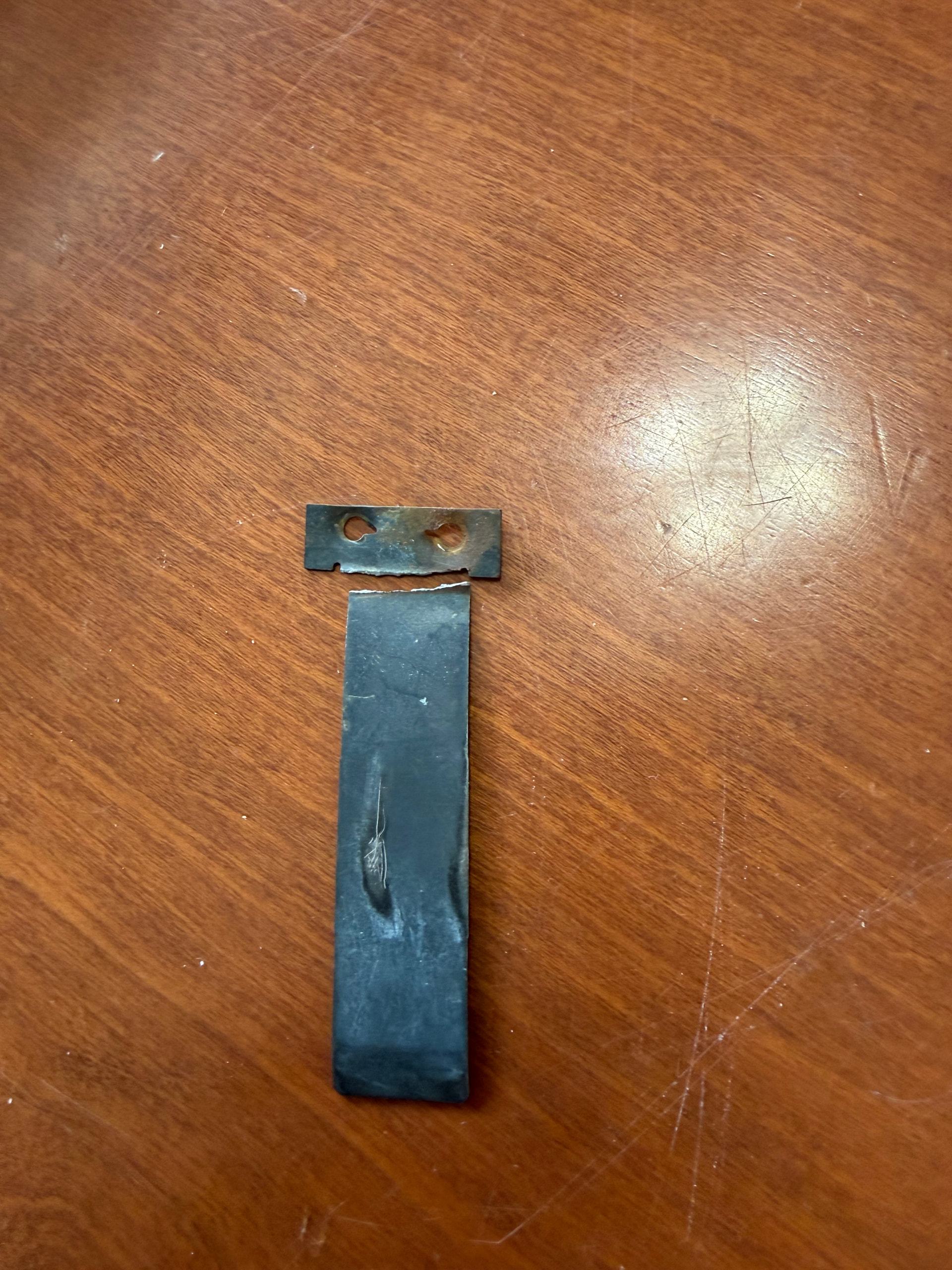

Kitchen Aid Trash Compactor KUCS03FTSS0 Thin metal piece that pushes in switch is broken
Brand: Kitchenaid
Model Number: KUCS03FTSS0
Main Symptom: Metal Peice on foot pedal broken

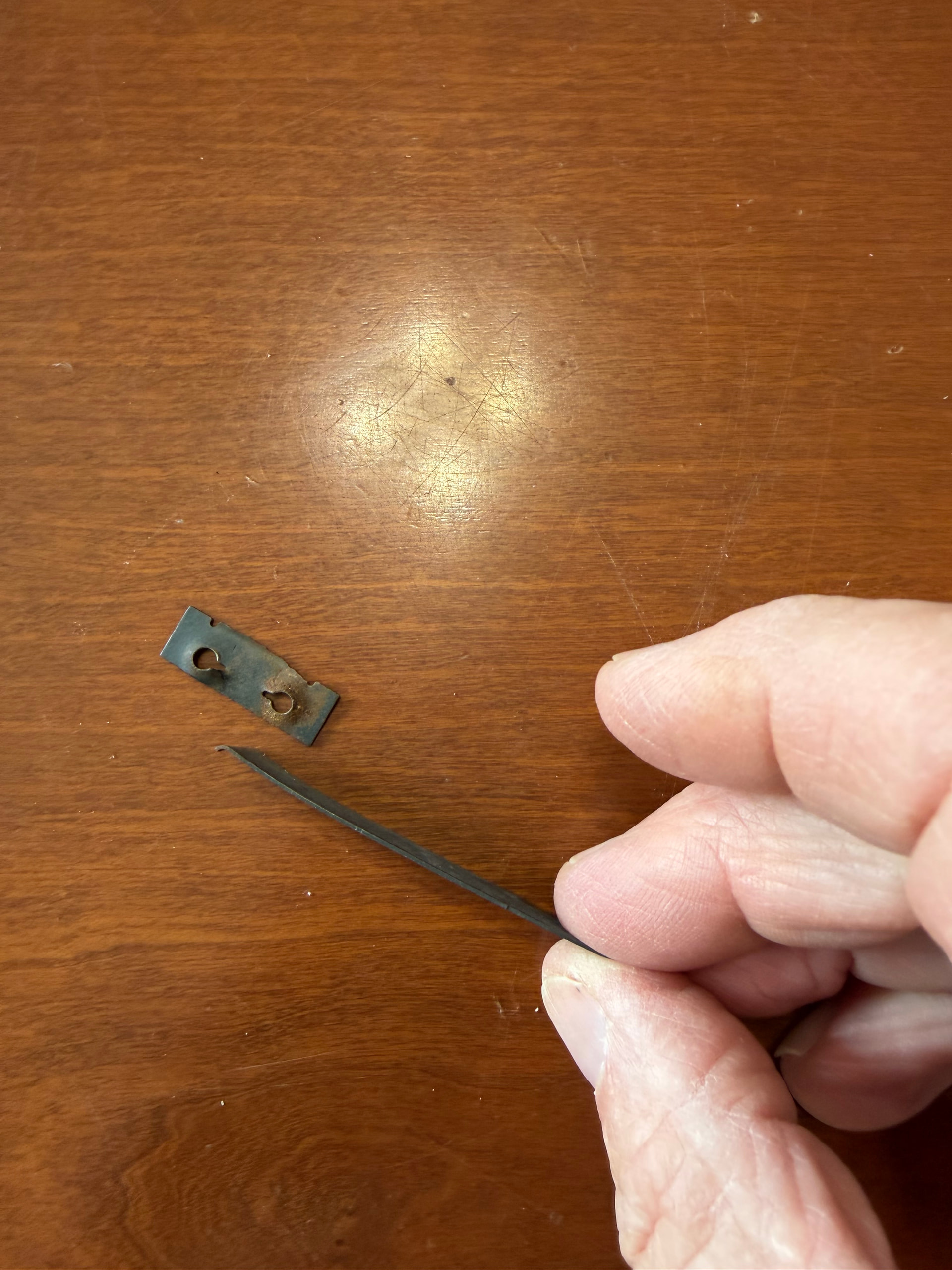

Thin metal piece that pushes in switch when you lift the foot pedal broke in two. I am only a Actuator Switch Kit for a part. I have attached a pic of the broken part. Can someone tell me where I might find this part?
I believe this is what you are looking for, it comes in a kit that is redesigned to work a little better. W10342596 Actuator Switch Kit | Genuine Whirlpool OEM In Stock
Thank you. I will check it out. Kevin
