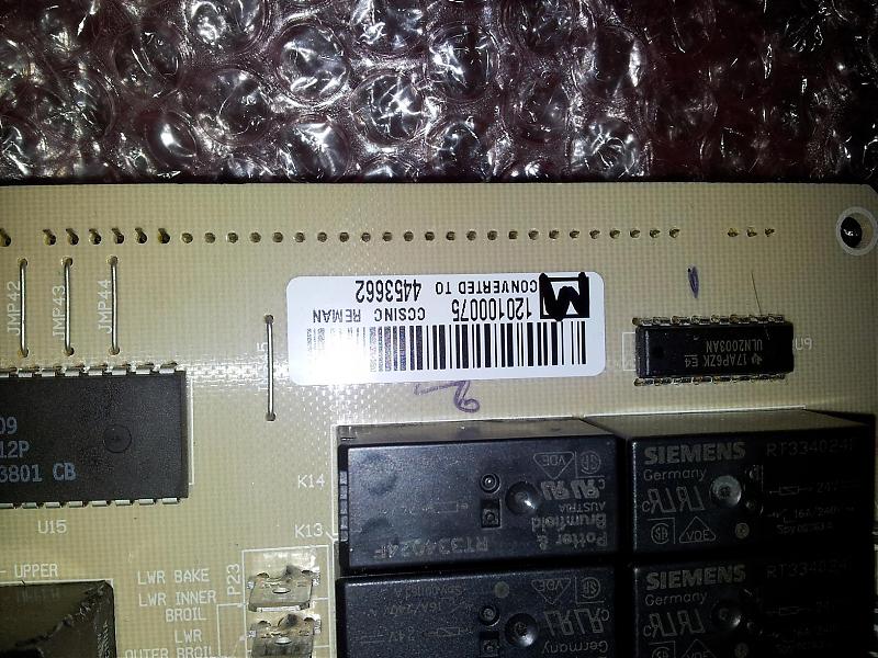

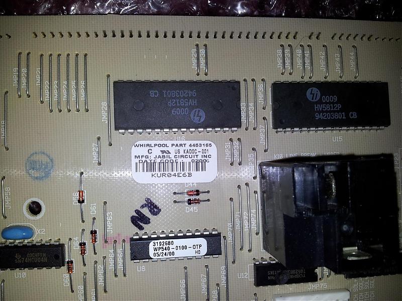

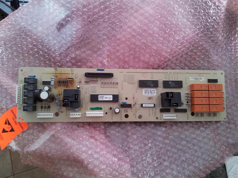

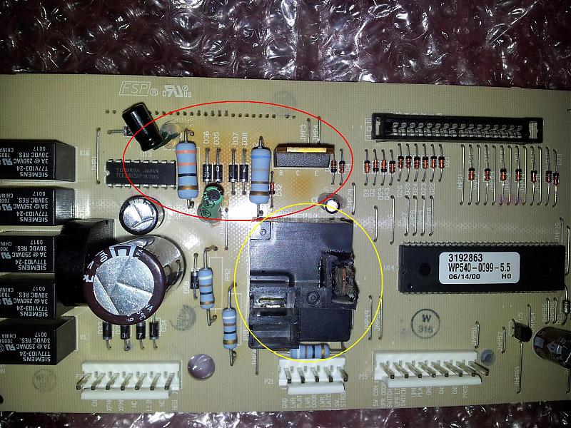

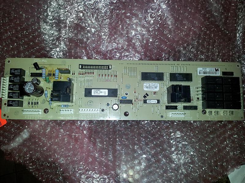

I have since removed the controller and can see (part of) the issue.
The attached pictures might help.
The picture with the circles is the replacement (remanufactured) board - the red circle was existing discoloration on the board and the yellow circle shows the new “damage”.
The replacement board was what they installed after taking my original board out - the part numbers do not match (maybe it is just a later version?) so that might be an issue?
The original board is back in the office and the oven is working normally (with the exception that the clock is not very bright. (The original board had stopped working and was just beeping but since it had taken 4 weeks to get a replacement board in when we re-powered the oven prior to them replacing the board, it was working normally (clock condition existed then too). )
(The first two pictures - after the model number are the old control board. The others are the replacement remanufactured one)
