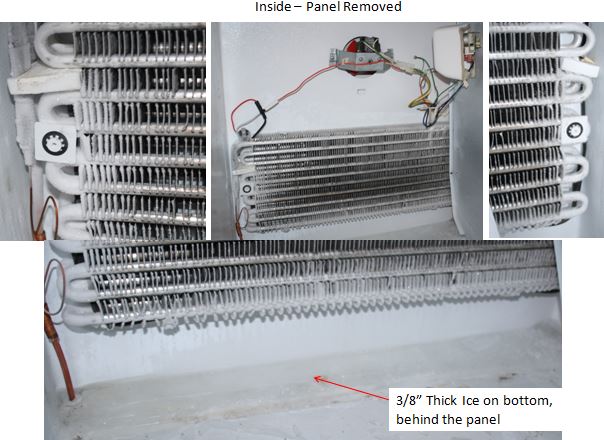

[COLOR=blue]To check for low freon remove the cover in the freezer and check the coils. The frost should be fairly even across the coil.[/COLOR]
I checked about 1 hour before an expected defrost cycle. See attached picture. The frost was light but seemed to be heavier on the right and left ends than the fin area. Not greatly though. I did find about a 3/8" thick slab of ice on the interior floor just behind the removed panel.

[COLOR=“Blue”]To check for low freon remove the cover in the freezer and check the coils. The frost should be fairly even across the coil.
I checked about 1 hour before an expected defrost cycle. See attached picture. The frost was light but seemed to be heavier on the right and left ends than the fin area.[/COLOR]
Normally you would expect more frost on the tubing ends as there is less mass (the fins) to distribute the cold.
Not greatly though.
[COLOR=“Blue”]Check the defrost thermostat. If it is deformed/bulged, replace it.
Where is this thermost located? I didn’t see any part that looked obviously deformed, but I could inspect the high res pictures again if I know where to look.[/COLOR]
It is the black device with a metal face clipped onto the top left of the evaporator coils.

Sounds like the drain is plugged

[COLOR=“Blue”] Also, where is the drain to the drip tray? I couldn’t find it but then again maybe it’s under that slab of ice.[/COLOR]
Often itb is directly under the evaporator coils. Does sound like it is plugged.
