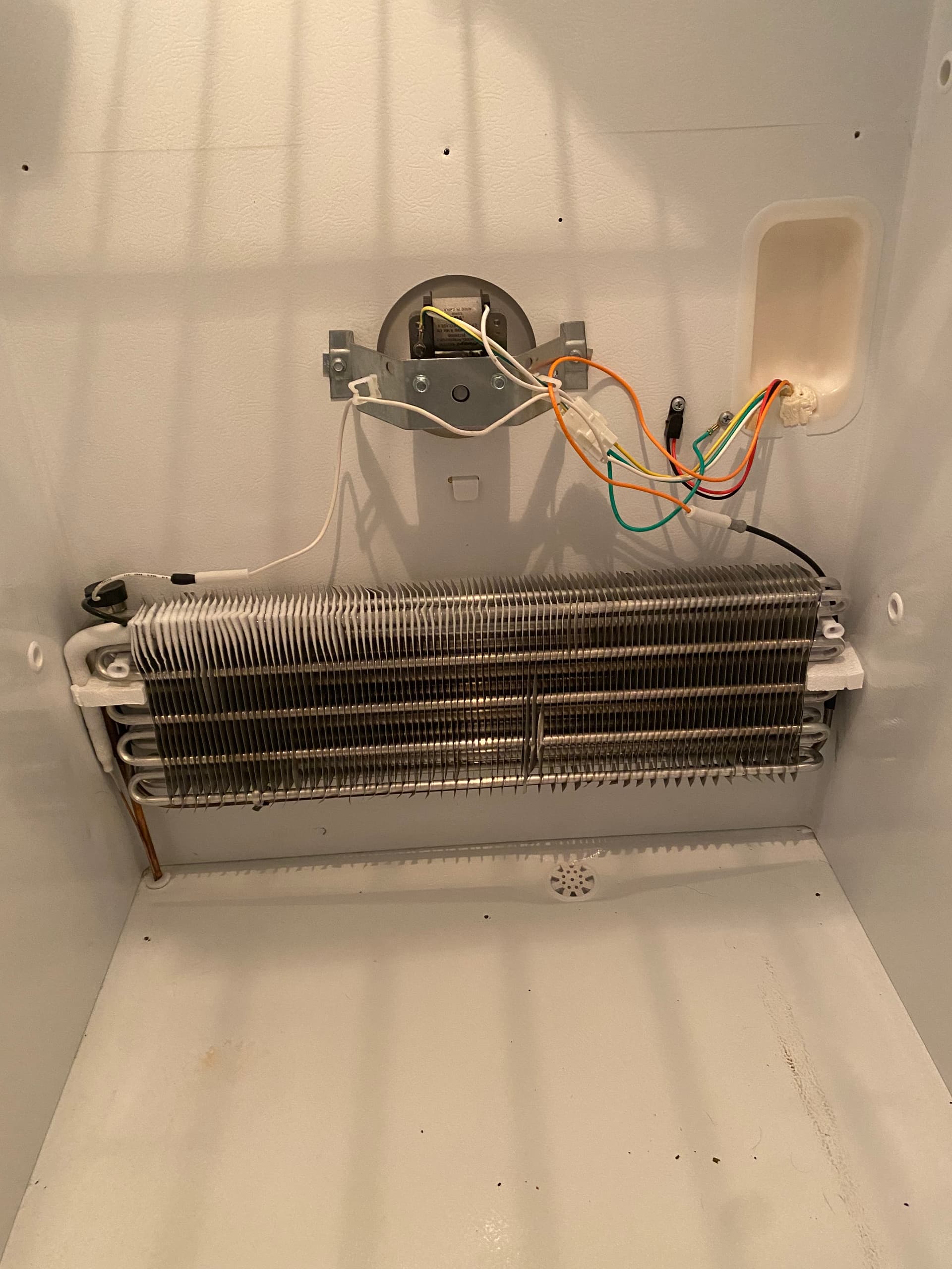

Kenmore upright freezer 253.28432809 cooling but not freezing
Brand:Kenmore
Model Number: 253.28432809
Main Symptom: Not Freezing

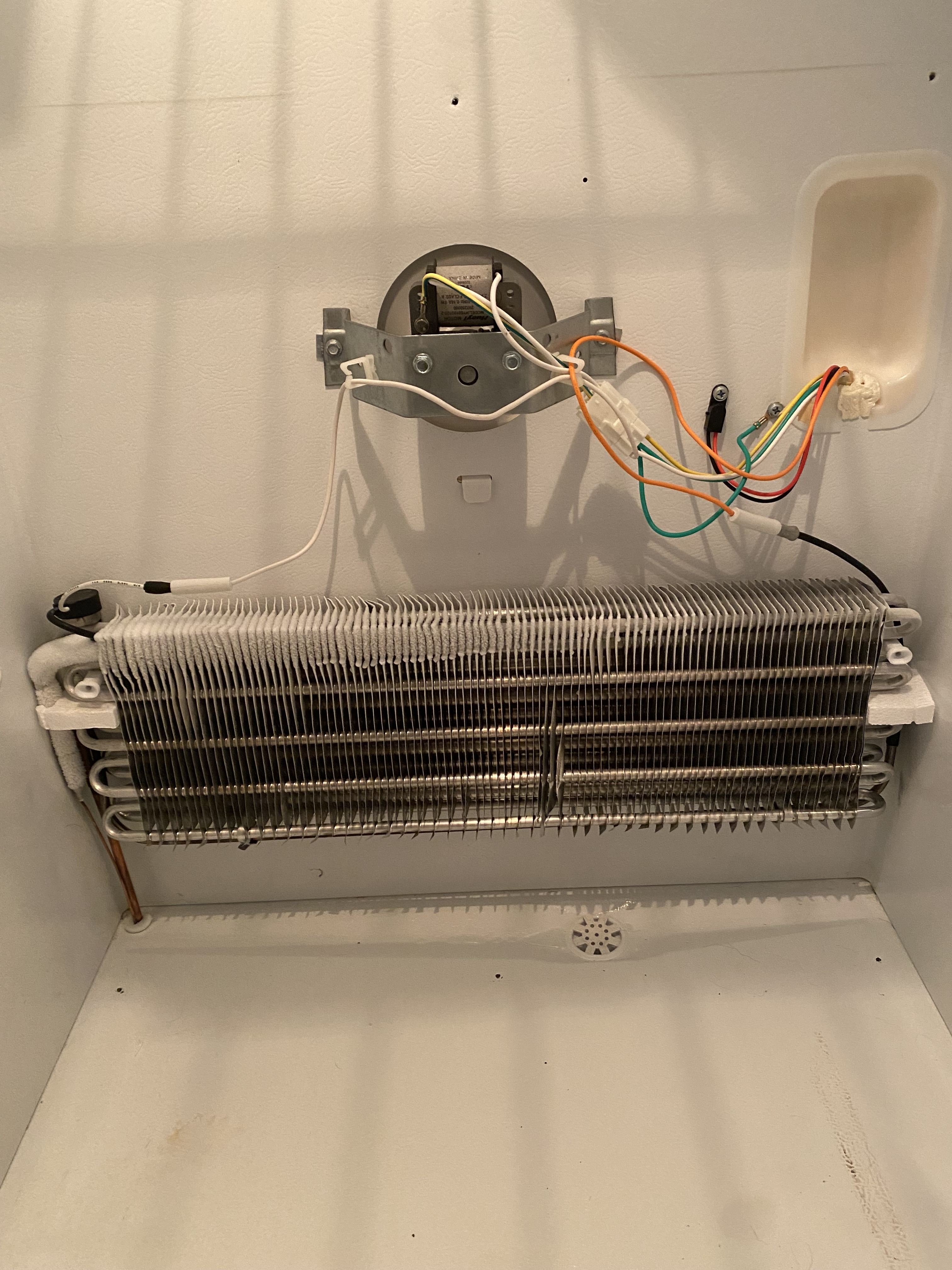

What happens & when: freezer was cooling but not freezing. Top section of coils were partially frosted over from the left side. Fan was blowing inside freezer. Freezer has been unplugged for a few weeks, and when I plugged it back in today, same thing. After 4 hours, freezer is at 60°, fan is blowing, and top of coils are frosted about halfway across from the left side.
Error Code (if any):N/A
Parts or tests already tried:none
Hello, I hate to be the bearer of bad news, but this looks like a sealed system problem. Either a restriction or more than likely a low freon charge. You would need a certified tech to verify this and make any repairs.
About 20 hours plugged in and freezer is still running and at 40°. Coils are still only partially frosted. Does this confirm your initial thoughts?
Yes it does that is a sealed system problem for sure!
