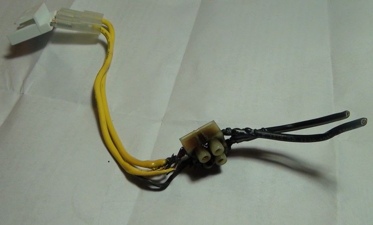

I have a Kenmore 16033401 dishwasher, but I don’t recall its exact age. I’d guess 5-8 years old. Like many before me, I had the thermal fuse blow for the first time about 8 months ago. Good thing I purchased 2 repair kits when the first fuse blew. It just did it again yesterday. I opened up the front panel, and this is what was melted to the plastic of the control board cover.
I tested the thermal fuse, and of course, it has opened. Good thing, too.
I’ve never liked screw terminals of the sort supplied in the repair kit, but I followed the instructions the first time around. Well, the terminals were obviously a problem this time, and may just have been the source of heat that tripped the fuse. So this time, I spliced in some slightly heavier gauge wire, soldered the connections, and protected them with multiple layers of heat-shrink tubing. (not electrical tape, which I feel it strictly bush league.) I had to splice in additional wire to make up for what I cut out.
If it happens again, I may go shopping for a new machine. I’m definitely not going to be running the machine when nobody is around. If anything happens, I want someone around to hear the smoke detectors going off.
I’m not impressed with the repair kit for this one.
